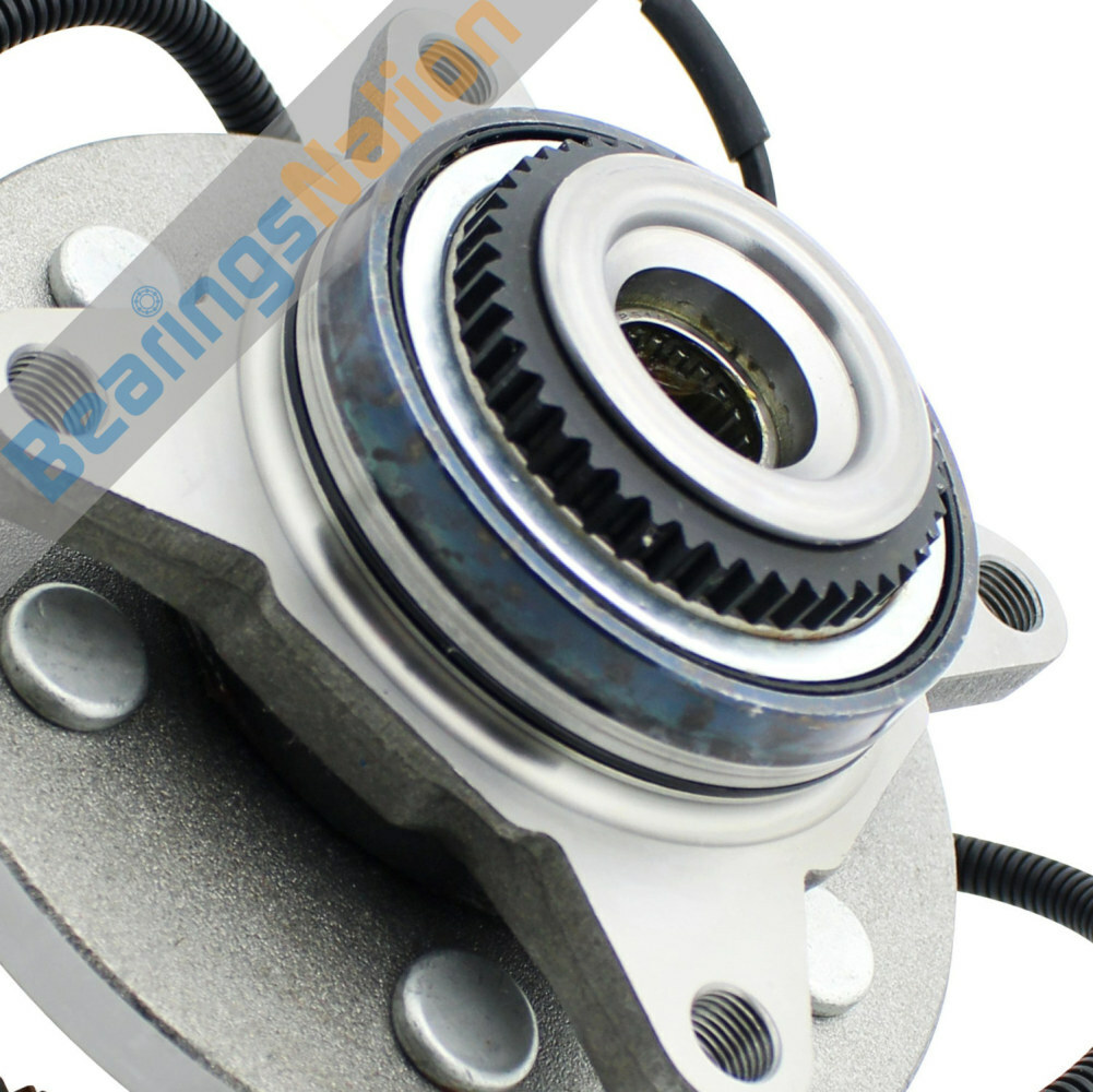

4x4 front bearings
Old Jun 9, 2021 | 11:13 AM
  #29
Papa Tiger's Avatar
Papa Tiger
Joined: Mar 2012
Posts: 26,235
Likes: 4,152
From: Near Cal. Avenue
Picture of the 2WD front bearings
A person can learn from the Internet just not Gospel usually. I have the F150 /2016 ford service manual !
