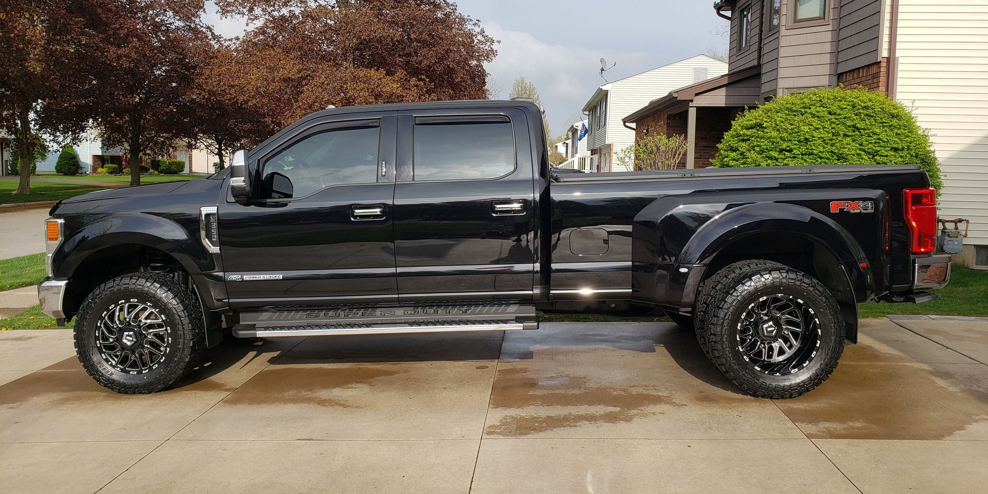

I just changed the pads on my 2020 and I only have 1,900 miles. I left the factory rotors and installed Powerstop extreme truck and tow carbon ceramic pads front and rear. Since I installed them I can say the dust has been cut down 90-95%. I have aftermarket wheels on my dually and didn’t want to deal with having to clean them constantly.
