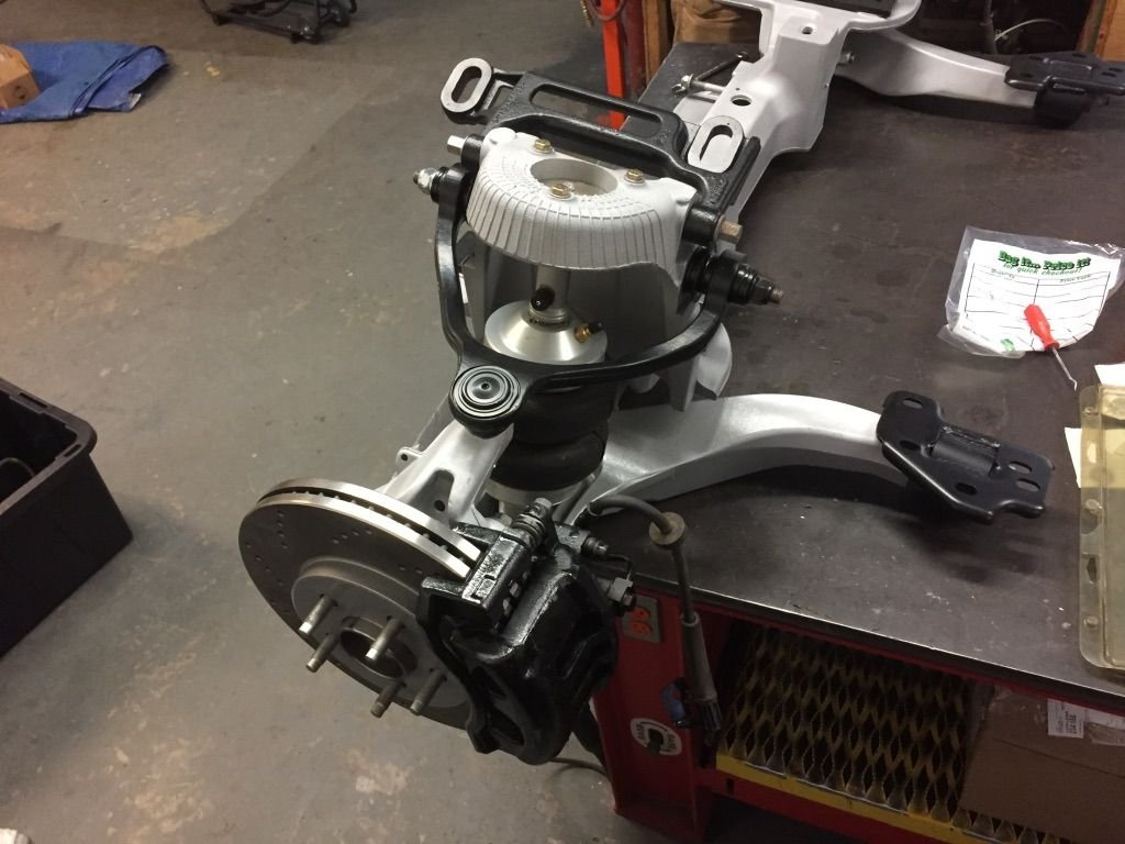

cleaned everything up; replaced the upper/lower A-arms & bushings; new rotors and airbags.

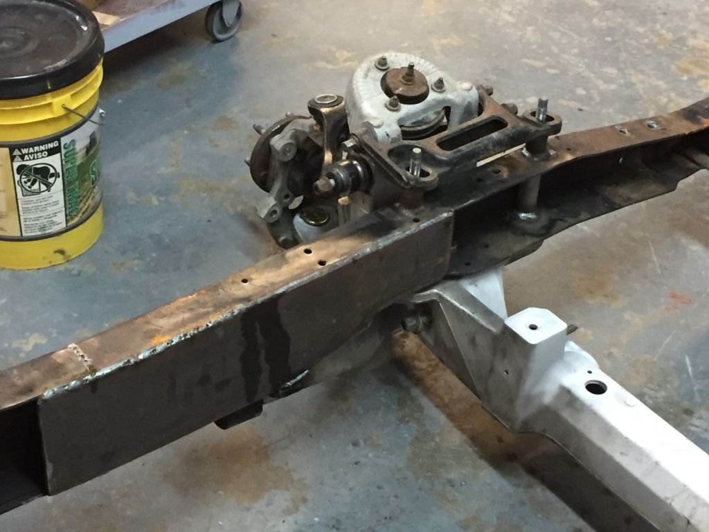

Frame upside down... made mods so the Crown Vic subframe will mate up to my truck frame. I must have flipped the frame 10 times during the modification and test fitting.
Close up (the frame is upside down) (front pointing to the left)
with the subframe sitting in place (upside down)
this is just a pic of the other side... (frame is upside down - you're looking at the passenger side from the under side.... front is to the right.

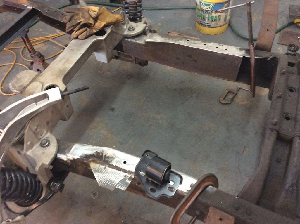

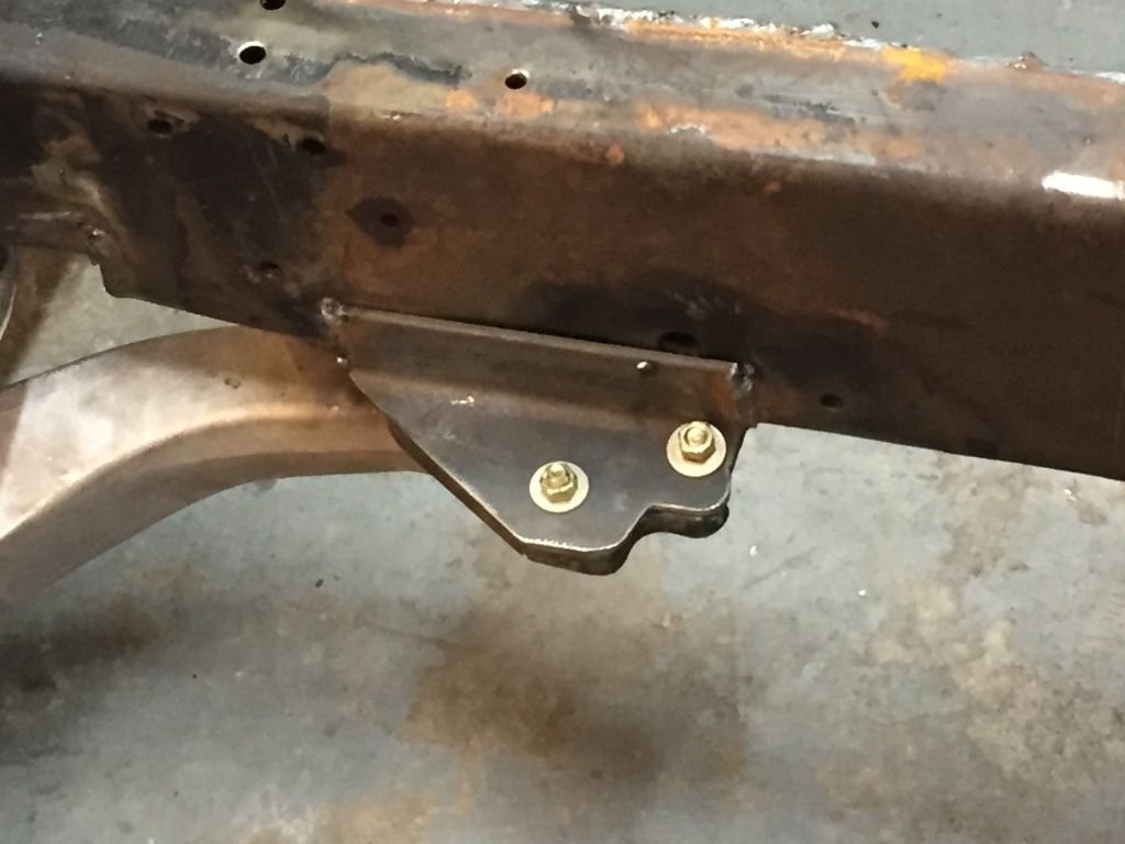

had to weld angle onto the frame to properly mount the bushing/mount for the from the rear of the lower A-arm. It's just tacked in place in this pic.
from another view... note I removed the lower A-arm. This is where I realized the rear bushing was rotated incorrectly on the mount for my installation...
pic from the inside of the frame -- you can see I decided to box my frame - especially where I had to make some slight mods to get the subframe to sit correctly.
outside of the frame - rear mount of the lower A-arm ... the angle is just tacked in place in this pic.

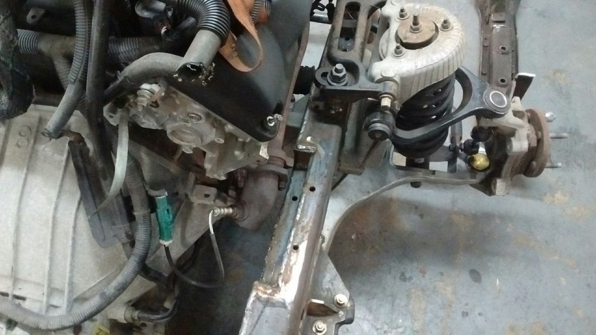

Note that I had to carve out a section of the frame on the passenger side to accommodate the exhaust manifold -- I inverted the steel and welded it back in. This was not an issue on the driver's side -- the engine is technically mounted slightly shifted to the passenger side -- this is designed that way in the Crown Vic from the factory.

I sandblasted everything... and painted the aluminum with a gray paint that matches the look of the aluminum so that it will not dull / corrode over time (this is before the painting)

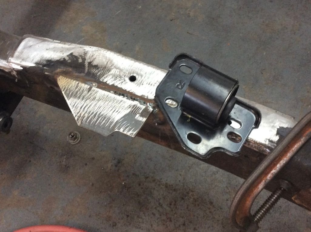

this is a pic of one of the lower A-arm rear bushing / mounts... after I cut the bushing loose and rotated it to match my installation and re-welded. Take note not to burn the bushing.
this is what they looked like after we rotated and rewelded
this pic is after re-welding both and sand blasting just before paint.

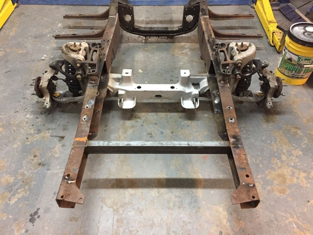

After all the cleanup, paint and reassembly
Close up of the driver's side
This is just after my first test fit with my actual wheels/tires. I must have calculated my wheel offsets at least a dozen times to make sure and it worked out perfectly. The rear end is out of a 98' Ford Explorer which is almost 9" more narrow than the Crown Vic - just comparing the WMS width

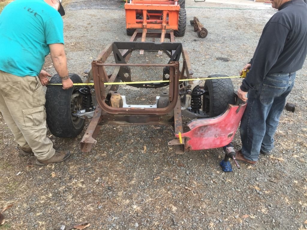

I'm confirming that part of my frame modification was that I had to go back about 3' and cut my flanges -- and I made my frame wider and then cut the flanges in the front and brought the frame sections back parallel at the correct width. It's been a while and I can't remember the exact width measurements currently.
you can see in this pic that we have the subframe centered and the bolt / tube mounting area is just outside my truck frame (prior to my modifications)
This is the pic showing that we cut the flanges about 3' behind where the subframe would be mounted and spread the frame using straps etc. to hold everything in place
if you look close about 3' behind the subframe, you can see where I cut the flanges on the frame and spread the frame members. We cut the flanges again just in front of the subframe to bring the front portion back in parallel.
The F1 frames should require a lot less modification to make it work... but it definitely can be done.
