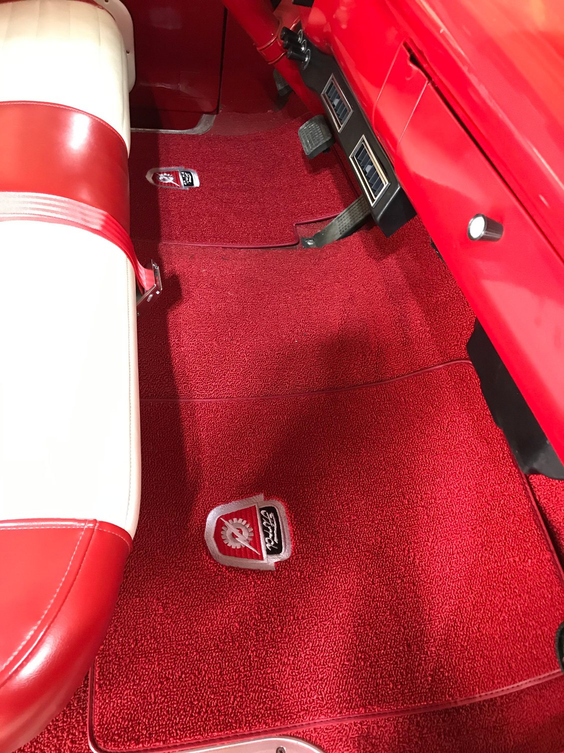

I put the 80-20 loop ACC carpet with mass backing in my F250 with the door step. The carpet is not trimmed to fit that step. When I made the purchase, I was thinking that I would get the edges finished by an upholsterer. However, after all the work of getting it installed and fitted around the shifters, clutch rod, column, seats, kick panels, etc - there was no way I was going to take it back out. (I had "extra" issues because the carpet did not fit my tunnel hump correctly - I believe I have a non-stock tunnel)
I simply used a new razor blade, with the step edge as a guide, and trimmed out the step - I razored it from 'below', and simply dragged the razor along the step. I was wondering how to finish the edge in-situ...maybe some type of heat applied edging, or... Ultimately, the bare trimmed edge didn't look that bad, and I got used to it. My truck isn't gonna win any shows.
From an FTE post, I happened on the scuff-plates from Carolina Classics. I took the plunge, and like the results. Before and after pics below.
BTW, the scuff plates come bare aluminum. The upper is a reasonable machined finish - you can barely see the end mill marks. I polished mine with Autosol aluminum polish.
Also, FWIW, I installed Dynamat and Dynapad on the floor first. I also have it on just about every interior surface, inside doors, etc. That, with the carpet, really cut down on road noise. The Dynamat is kinda like a mastic - super sticky, pretty thick. I'm pretty sure rust isn't going to happen where it is stuck, but also sure it's going to be impossible to remove.

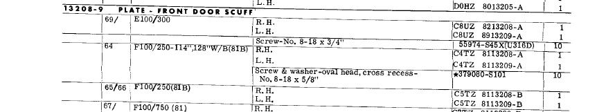

Just some history. Some of the 1964 Custom Cab trucks actually got the curved scuff plates from the factory, but not some like 4x4 and F350. If they had done that from the factory on the passengers side on the trucks with the battery below the floor boards you'd have to remove the scuff plate then turn back the black floor mat and then access the cover to get to the battery connections. I've always suspected they didn't use them on those models for that reason. I've thought about going to a battery with side posts and swap cables to the same connections - then you could fairly easily get to the battery connections without going through the floor board access cover. Not available before 1964 - then in 1964 it was Custom Cab (81B) with 114" and 128" wheelbase (2WD trucks) which excludes the 120" (4x4) and 132" (F350).
For 65/66 only the 2WD Custom Cabs (and 1966 F100 4x4 Custom Cab) and it was the different style of scuff plate. Like at this link. Door Scuff Plates - Pickup - Pair for 1965-66 Ford Trucks | Dennis Carpenter Ford Restorations (dennis-carpenter.com)

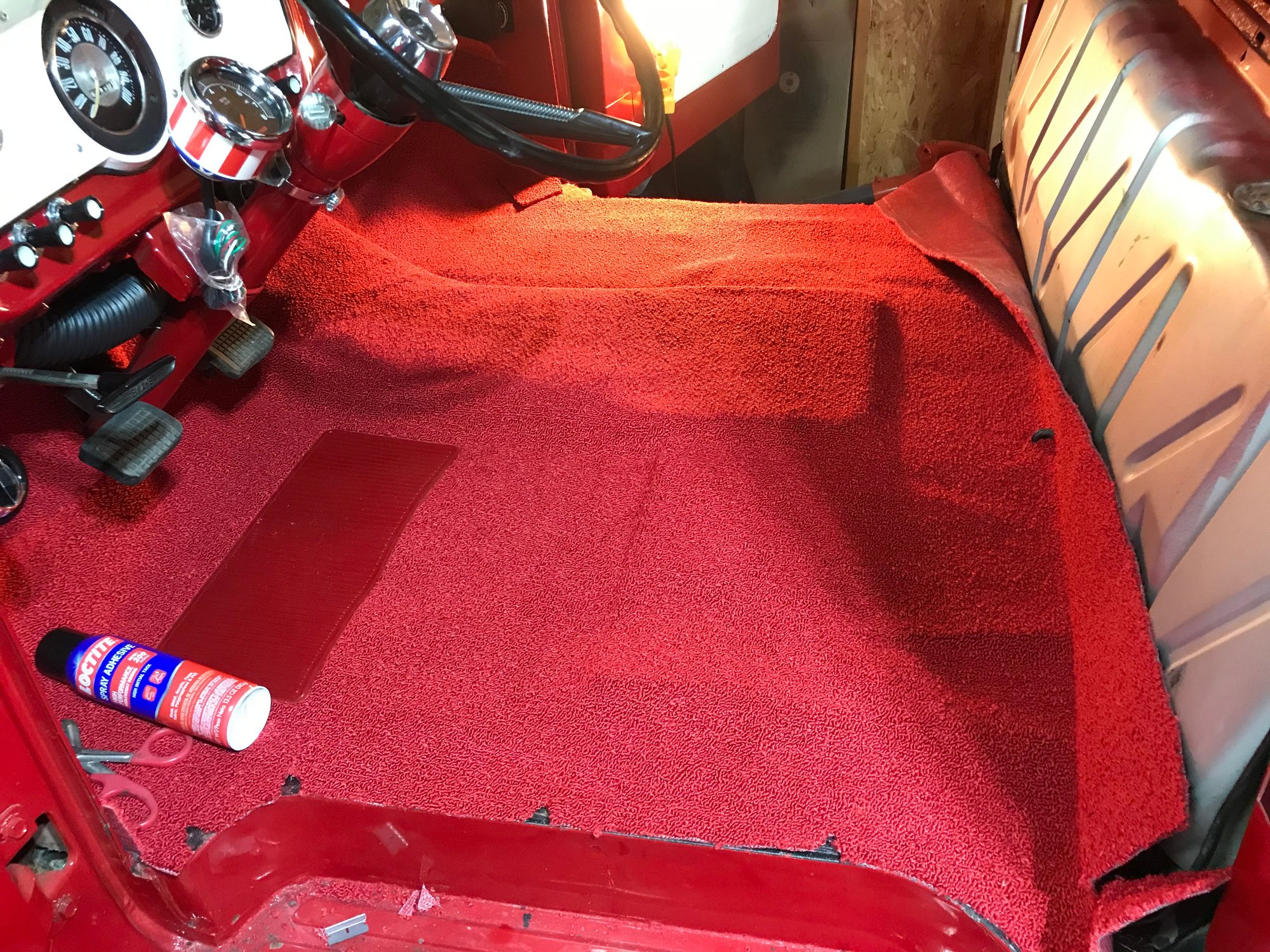

My PO had a carpet that was trimmed with vinyl around the door edge. It was slit straight along the front base of the passenger seat, from the door well to the tranny tunnel, and had two snaps at the edge (one on each side of the slit), that kept it down. Allowed access to the battery door. It was a good install, just worn-out by the time I got it.
I probably would have used a bit of spray glue along the edge, if I hadn't landed on the scuff plates. That spray-on is pretty easy to pull up - something like 3M "General Trim Adhesive" is really easy to pull up, or even a "Headliner" adhesive would probably be OK, since carpet is pretty strong and you can yank on it. Let me see if I have a pic of that slit in the carpet...
