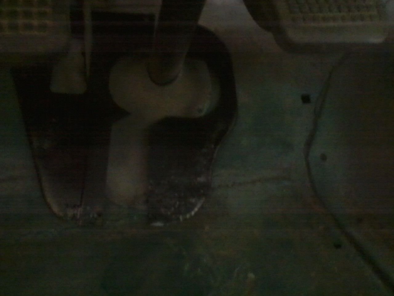

Another question - does the plate (that secures the rubber firewall seal for steering column/clutch rod) go under the carpet or above it? thanks.

I installed my carpet over it.

I installed the cover plate to the floor - under the carpet

Did the same on the 65.

OK, 3 for 3. So I attached it first

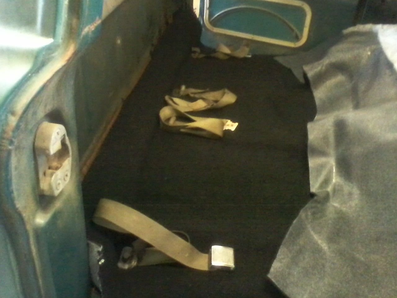

This afternoon the carpet came FedEx (one day later than originally promised, as usual), so I unrolled it and let it sit in the sun for a bit. It really didn't have much wrinkling at all (and it is the one that fits my floor)
I made four holes (locate with an awl, then cut out with a pointed X-acto knife) and bolted the seat belt ends in. To finish unrolling the carpet I will have to carefully cut holes for the two shifters, parking brake, dimmer switch, clutch rod and the steering column. Also it needs 2 or 3" of extra width trimmed off each side. Good to have extra material anyway! Better to do that when I'm not hot, tired and hungry 😉

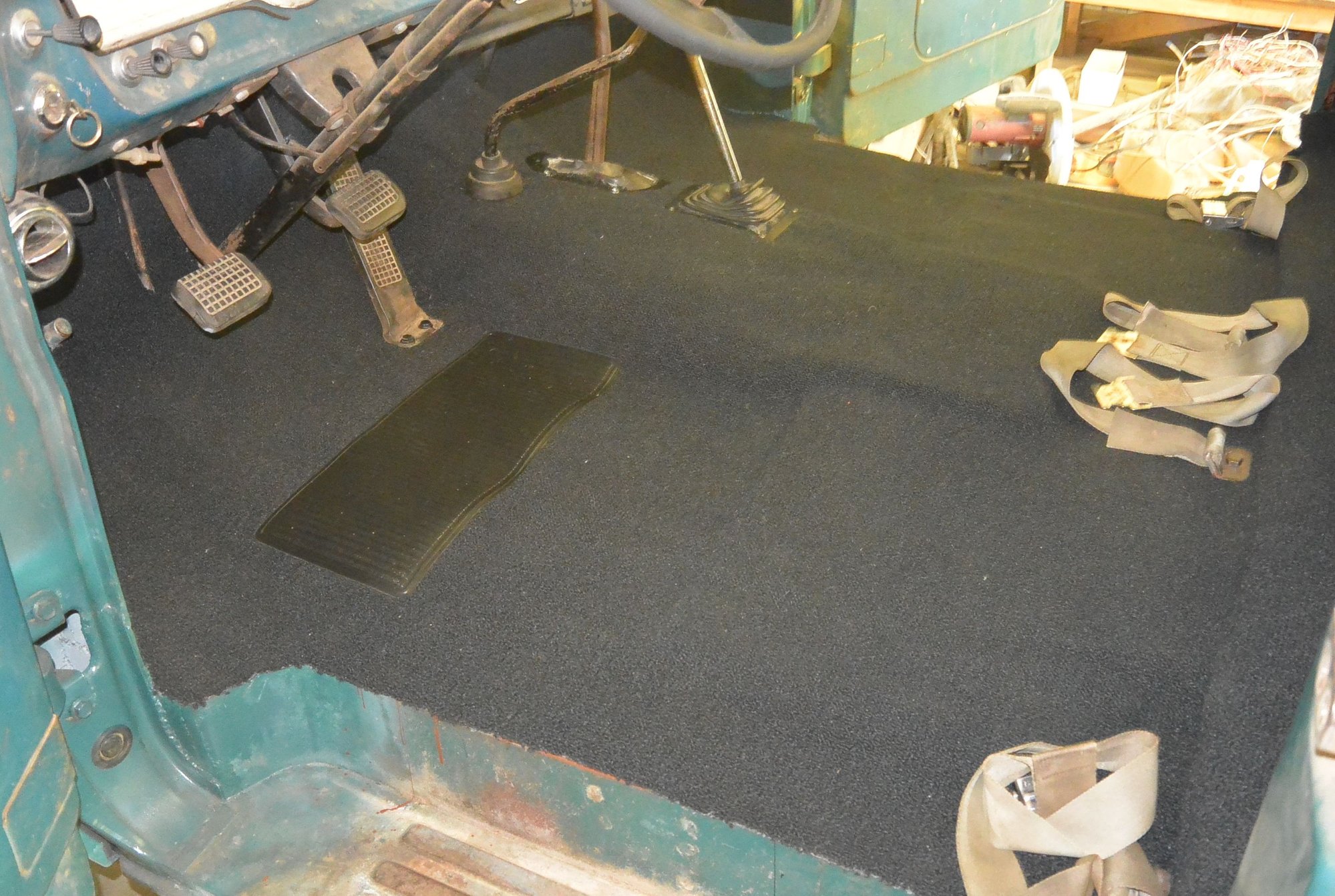

The truck carpet is progressing. There are a lot of holes that have to be cut, carefully. Then finding the original screw holes for the bezels is also an interesting exercise.
I found the easiest way to remove the shifter from the NP435 was to use a roll of double-width electrical tape. That helpful advice showed up on a Google search for removal - possibly even here on F-T.com... anyway the tape is soft enough to push down with my hand, hard enough to compress the spring, and the friction between the tape edges and the round clip was sufficient to rotate the clip. So I just pushed and turned. Only took two tries to get it back on, too!
Too hot + humid to resume work this afternoon, will start again in the morning.

I did something similar, but without getting under the truck. The larger bolt holes are easily palpable through the carpet, so I'd stick the awl through from above. Then cut the X with a pointed blade. For the small #8 or #10 bezel holes, I lifted the cut edge until I could see the hole in the sheet metal, guesstimate where the awl should come through, and poke away!
The remaining openings are for the steering column, clutch rod, and dimmer switch. I think the first two will get a slit from the firewall end, with a larger hole where the column and rod come through. Then the dimmer switch hole should be easy to locate.
This carpet has about 3" of excess width (not counting the cutouts for the steps). So I'll need to make some very straight cuts on the left and right borders, and follow the curve of the step accurately too. Any thoughts on dealing with the cut edge - carefully melt with a propane torch? Glue some kind of binding? Could an upholstery shop sew on a binding in-place with a portable device of some kind?

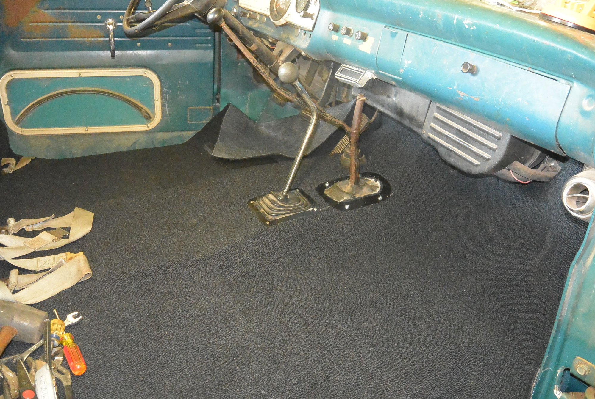

Thanks for the suggestion. I'm wary of using edging because the screws that secure it will be several points where rust could start... maybe some spray adhesive along the borders, to just glue it down

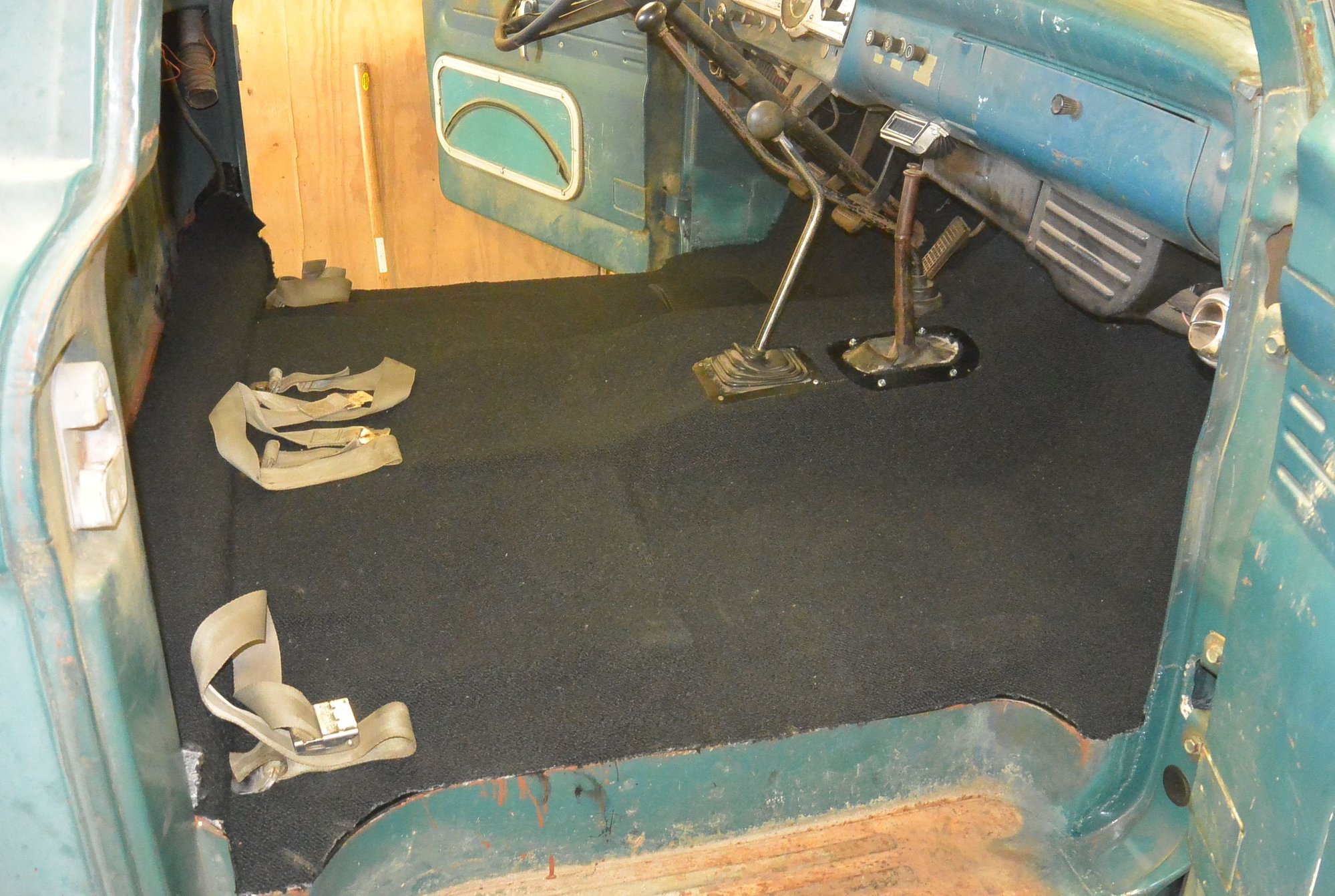

I made the remaining holes and cut the edges. It could use a fine trim with a new razor blade. The right rear corner does sit flat when the flap inside is held against the A-pillar, so I'll glue it there.
Still thinking about the battery box cover. I could cut the carpet out there, but it's an area where the edge can be stepped on and frayed... I may just leave that edge loose so I can pull the carpet back if access is needed.
