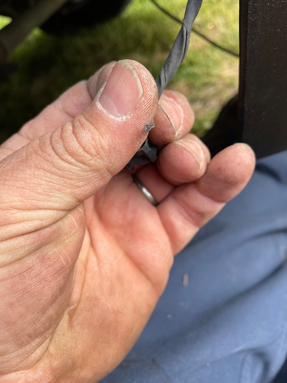

Found this in my fog light connectors all rubbers seals were in place no knicks in wiring. Foglights stopped working. So something in the process is flawed. 2017 F250
