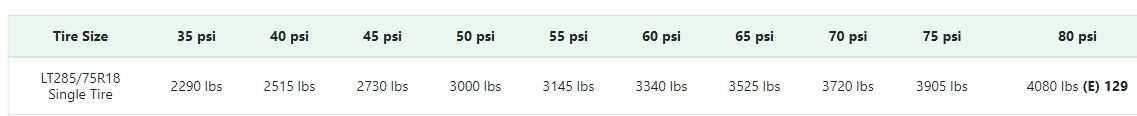

I run 50 psi in my 35s when unloaded. I'd think the Tremor's suspension would be somewhat 'softer' to allow for greater articulation.
Here's pressure specs based on load for the LT285/75R18s:
