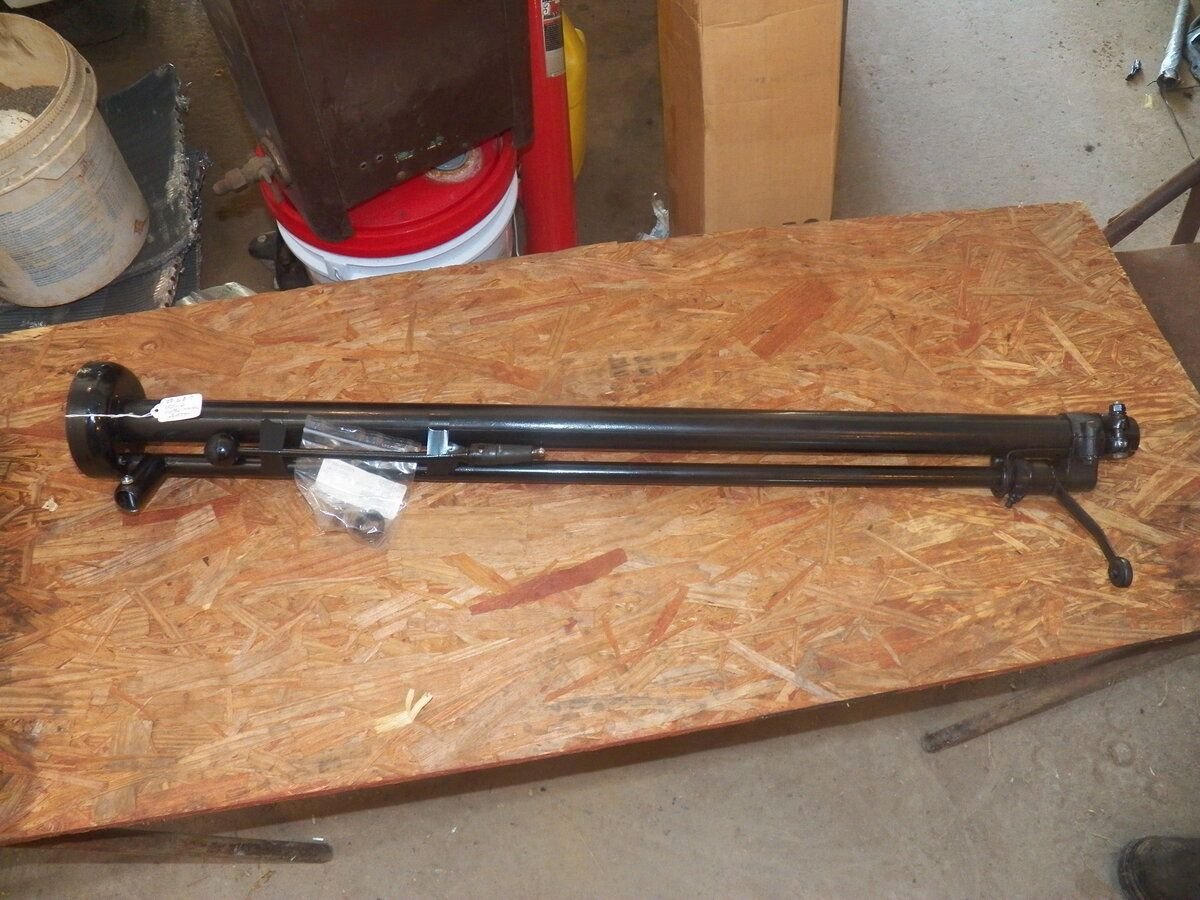

As I look for parts occasionally either I find a part from my truck that I misplaced or I locate one somewhere here in the lower 48 that I can purchase and have shipped to me. Last week I found my old 3 on the tree shifter column rod. The hand shifter part was not with it and I haven't seen the column cover. I have yet to look in my old bus storage area for missing parts. In the 1970s I had installed a 1968 FE 390 and C-6 and was shifting with one 1/2 of the 3 on the tree. When I would park it then I would shift in to the other half of the 3 on the tree as a theft deterrent.
Recently I located a 1953-55 Automatic shift column. As my dead Chevy friend would say "It's made of unobtainium".
I want to thank the Octogenrian out in the desert southwest who 40 years ago had the foresight to collect, save and protect the antique parts that he is now selling in his later years.
EDITED-In order to correct any incorrect information, I decided to ad this. This IS NOT an Auto column. I had located one but it turned out to be one for a 1956 F100 which has a shorter column tube and steering shaft. If the person who "educated" me on this reads this, thanks and I have learned many more things about these trucks in the process.
Added 2-5-22 A few months back and 4 months after I purchased this column, I was able to negotiate a partial refund.

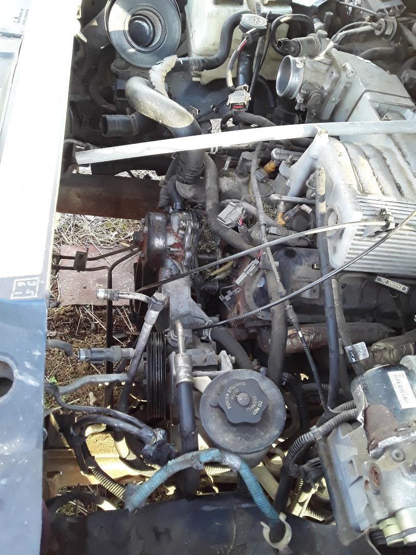

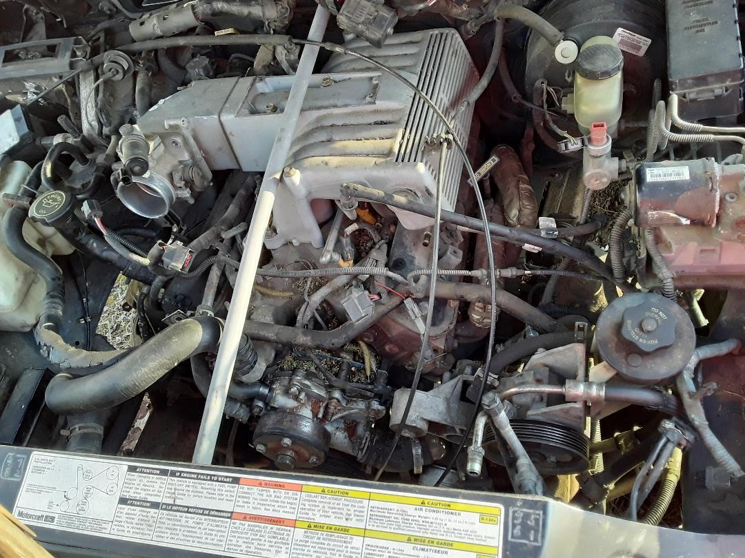

Recently I purchased a running driving Ford for the donor engine for the 1954 F100 project. A 1997 Mercury Mountaineer 5.0. Actually I will be using the complete drivetrain. It has a 4R70W automatic behind the 5.0 and an 8.8 differential in the back of it.
I don't have an under hood picture of before I started working on it. It had a leaky water pump and I wanted to get that straight before it caused future problems. The work space to get to the pump is limited and requires removing quite a bit of parts to get down to the pump. So much that I might as well replace the timing chain and gears while I'm down in there. These are about the best 5.0s that FoMoCo built in the past before they quit making them. A plus for the project is that all of the power steering pump and AC etc is all on this engine and will work with the power R&P and AC that will be added to the old truck.
Here are a couple of under hood pics, dirt and all.

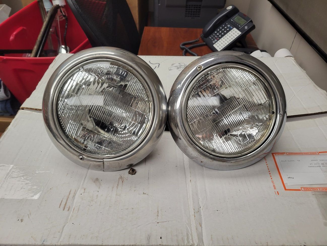

More parts purchased 2021 and Jan 2022
Painted Wimbledon White. What was the original paint code?
Rear 1956 lamps. Cheap. Has plastic housings from Ching Chang. They will do for now. More than likely to get damaged and need replaced later.
Head lamp assemblies. Good used condition.
