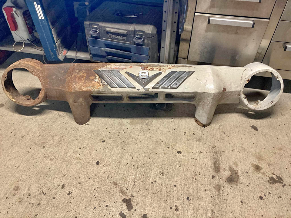

Original Ford color of 1954 grille was Sungate Ivory. Yours look close. Grille in 55 was Snowshoe White. Painted grille in 56 was Wimbledon White.

I found a grill 65 miles from me. It looked like it had been in a shed fire on one end of it. Took a closer look and it looks like someone was using a small propane torch to heat the top layer of an enamel paint job someone had done. It's not heat warped.

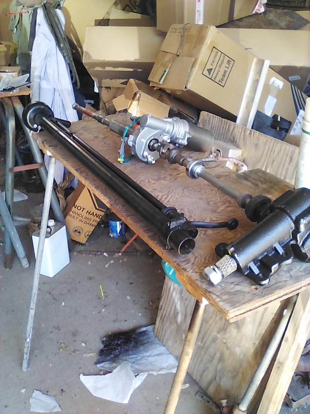

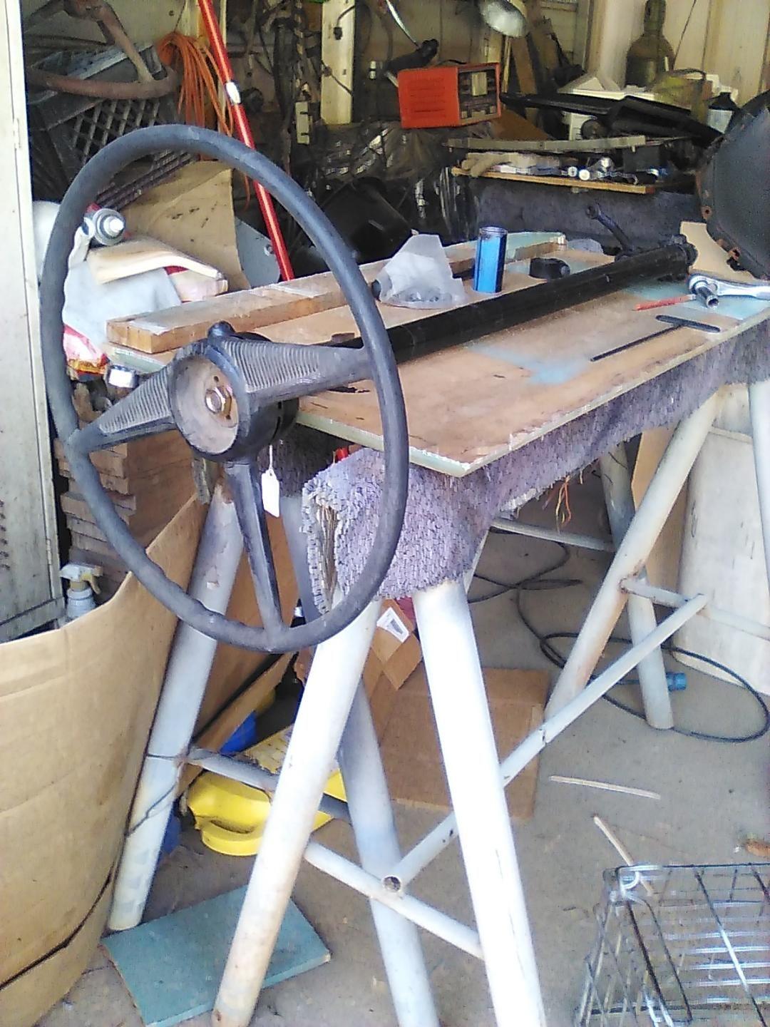

Today I have been able to put my hands on one part of this truck project. The steering column.
Please ignore the other Ford column in the picture
If your special column bolts are missing you can make copies out of 5/16" carriage bolts. Grind down one side to lock in to the lower horseshoe shaped bracket. The original were fine thread bolts

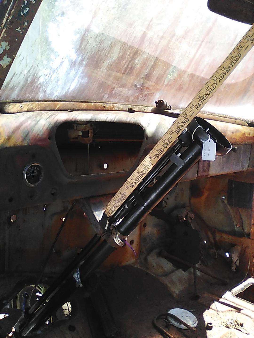

Column in the cab. I used a little piece of duct tape to keep the upper horseshoe bracket from sliding down during assembly. A hose clamp will work too. Turns out that I had to use a hose clamp to keep the column from sliding down in the bracket. there must have been a rubber piece in the bracket to tighten it up.

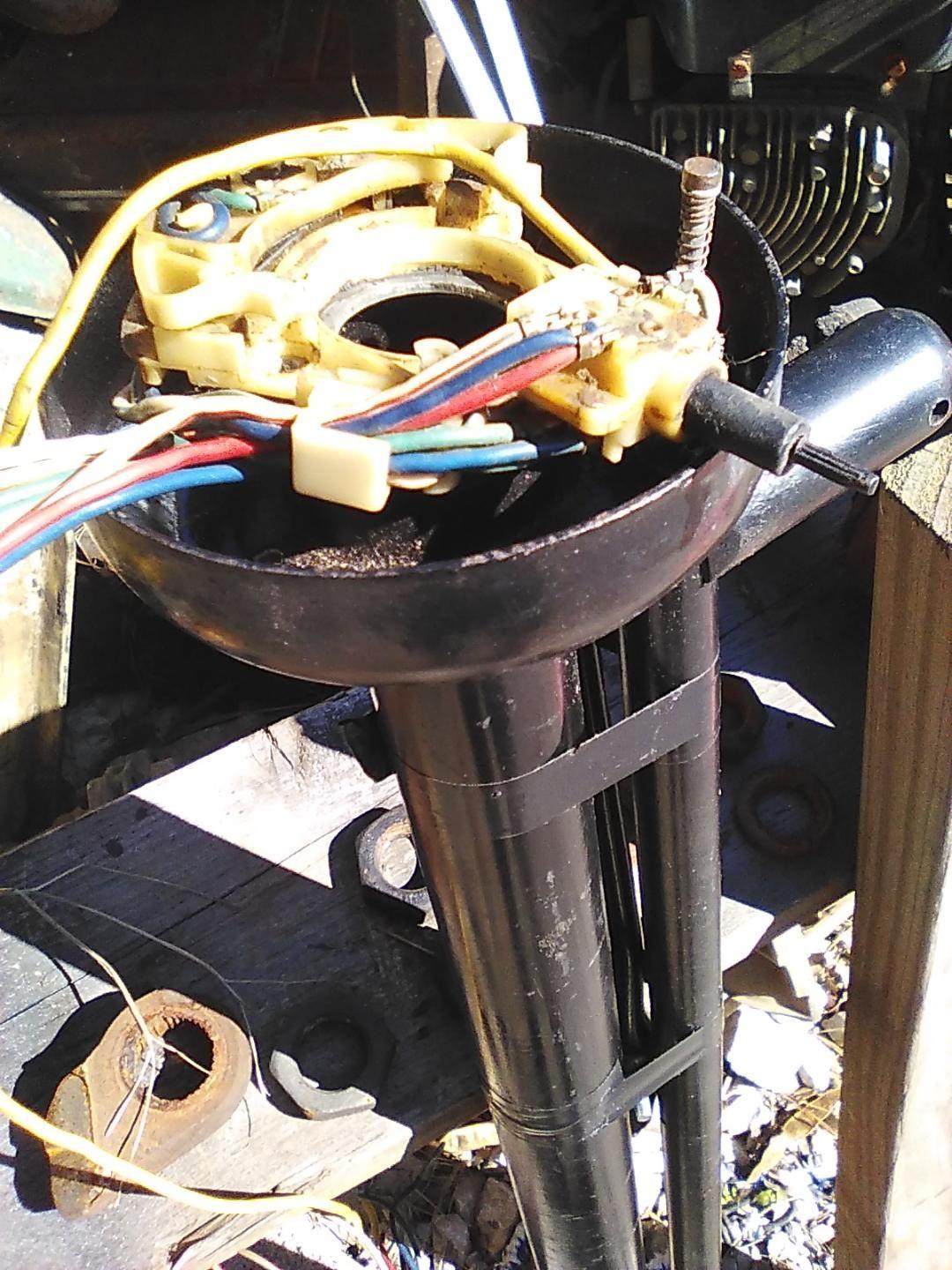

I know original type turn signal switches are available however, I'm looking at using a switch from a 1968 Mustang with the Emergency Flasher switch. There appears to be room and would require that one hole on the bottom of the bell needs enlarged and make a notch for the E flasher pull out button

Now I'm to the point that I need another measurement before I can cut the column housing. Does anyone know OTTOTH (off the top of their head) know how much the shaft sticks past the bell? Dirk will need to know this too.

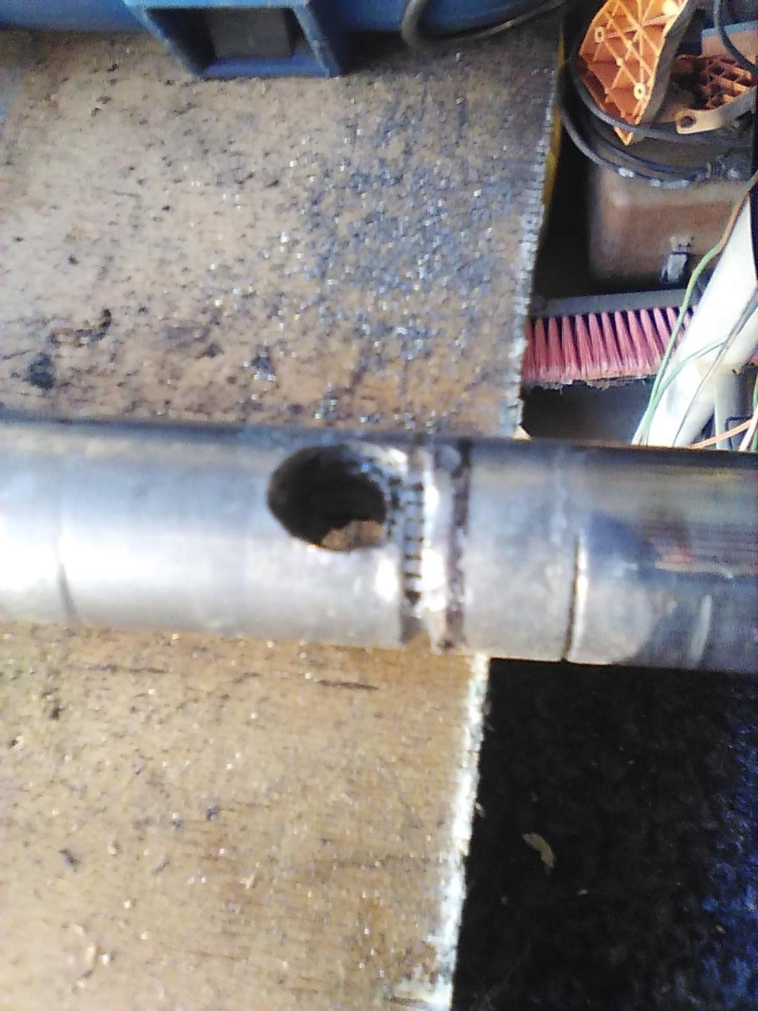

The shifter rod has to be shortened too, however I'm not going to cut off the same amount. I'm taking a little less off of it. The bottom shifter bracket will also serve as the clamp to keep the bearing in the bottom of the column instead of using the separate clamp.
There is a factory slug inside the hollow tube that has to be reused. I successfully cut around the shifter tube and removed it.

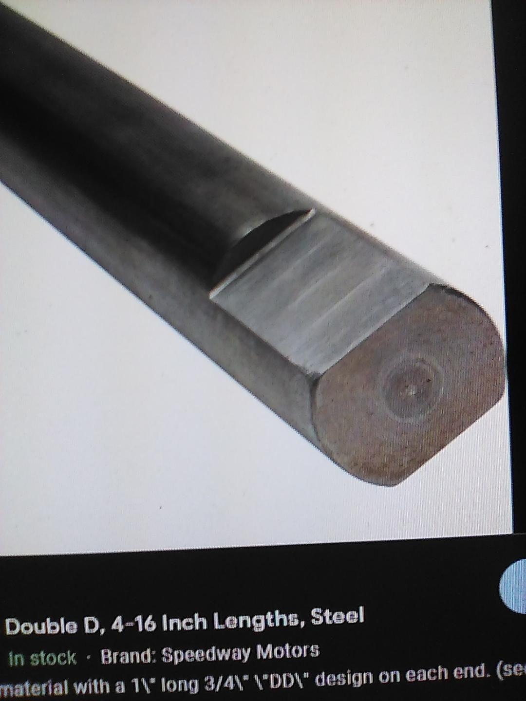

Here is file photo of the "DD" type cut that I'm having the Machinist cut on the bottom of the steering shaft. It is still at the Machinist.

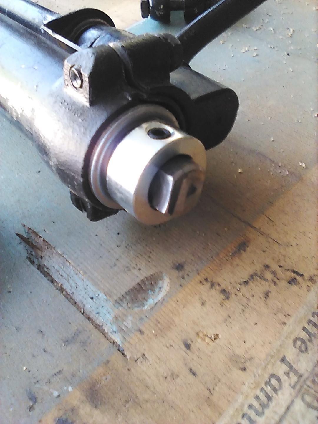

Steering Column cont:
Today I got the steering shaft back today. Machining seems to cost more than I remember. No Olive Garden this Friday night. The bottom end now been cut to"DD". Two universal joints and a piece of steering shaft will get it down to the R&P.
The collar is temporary until the u-joint arrives.
The steering universal joint will be snugged up to the bottom column and act as a retainer too.
I may have to shorten the column tube another 1/4". I want the shaft to bottom out in the u-joint.
