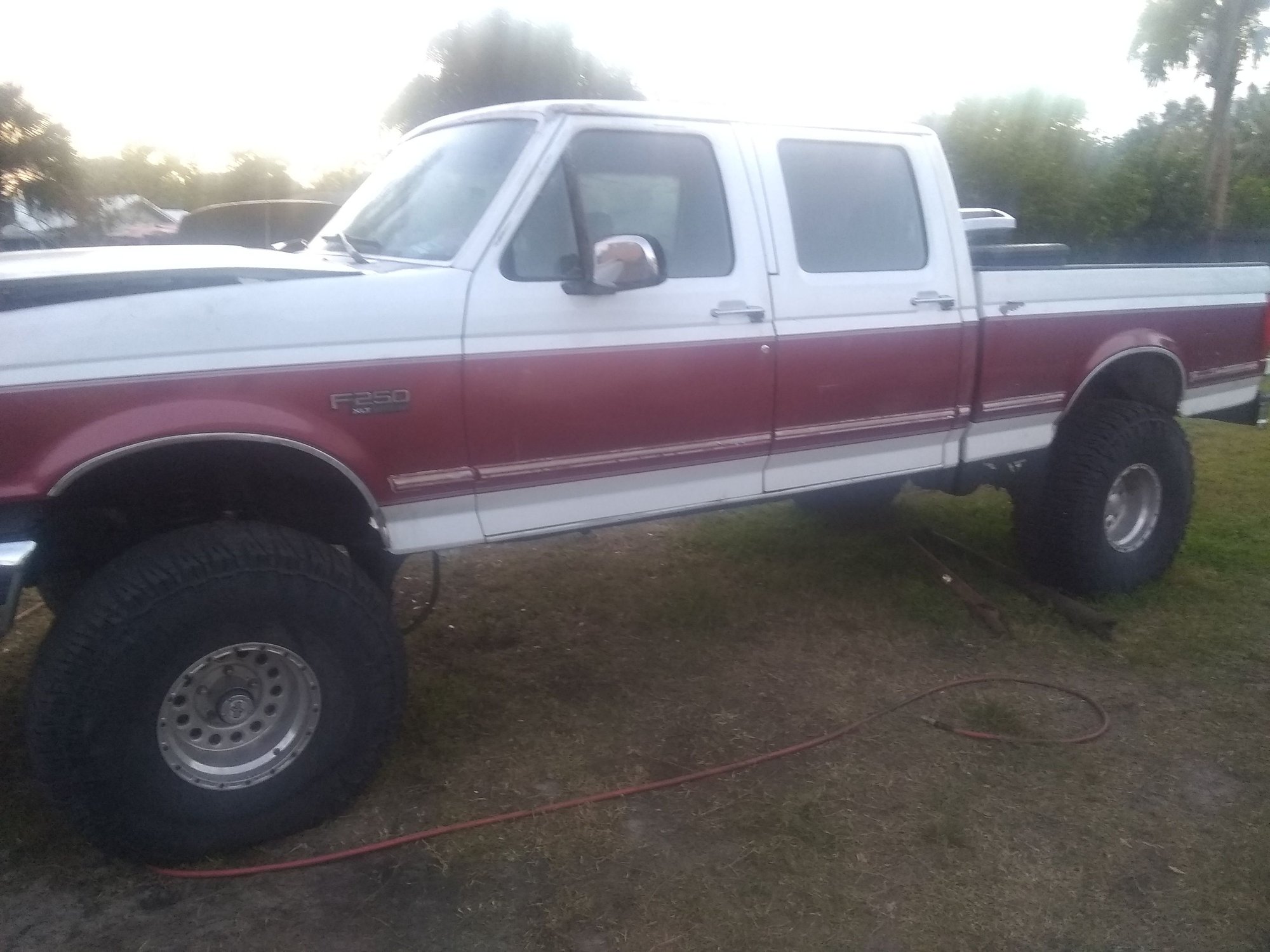

You try to check for codes, see if any trans codes come up, or is OD OFF flashing on shift lever, is this your Monster Truck Crew Cab F150?

Man! Awesome truck, you could do a few of these checks-->E4od not shifting into gear after a long trip - Ford Truck Enthusiasts Forums

Thanks, it is an awesome truck....if I can ever get it finished. It looks a lot better now, thats an old picture. I think he broke the shifter rod or some part of it. The truck was in 4X4 and low range with just the front driveshaft in it when he slammed it into park. That had to put a lot of stress on something. I wish one of these tranny guys would tell me what to check and if it can be repaired without pulling it out. That one article said I could drop the pan and see the shift rod. C'mon transmission guru's, What's broke and how do I fix it.
