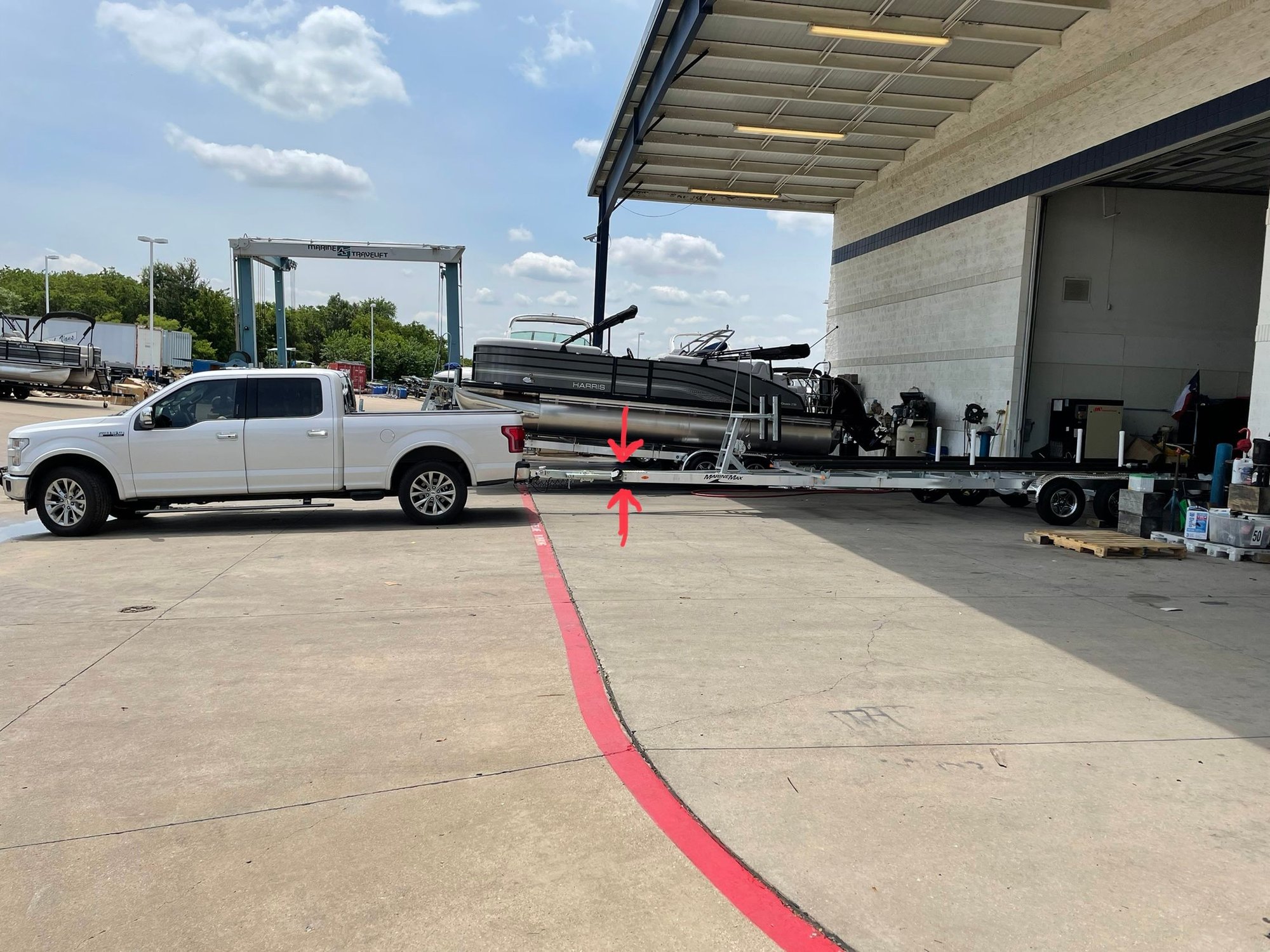

I picked up a trailer and want to get a weight distributing hitch set up for it.
The issue is that the tongue has a very long straight section before it branches out, its a few feet long.
Does anyone have any thoughts on a model that will work for that situation? Or would any of them work?
Here is a pic, with red arrows pointing where it starts to branch out.

You may or may not need a wdh for a boat. Typically boats have much lighter tongues. That said, a great source for advise and parts is etrailer.com . That said, make sure you get something compatible with surge brakes if that is what you have. They do make brackets for this situation.

So, it sounds like a lower percentage of tongue weight to trailer weight is okay with boat trailers.

You are definitely overthinking it for a boat trailer, especially a pontoon. I have a 30' pontoon that I put behind my wife's F150 and it barely registers that it's there.
Remember that while boats can be heavy, most of the weight is at the back (usually - I will add the caveat later). So most boats are only on the trailer enough to add some tongue weight and that's about it - I can lift the tongue of my boat trailers with the boat on it.
Now, larger boats (or sorta-big boats on too small of a trailer) on the other hand, will come with a lot of tongue weight. But those usually have bigger couplers and require a bigger ball (2-5/16 instead of 2"). In that case you might want a WDH but for a pontoon of the size that will fit on your trailer? Nothing to worry about.

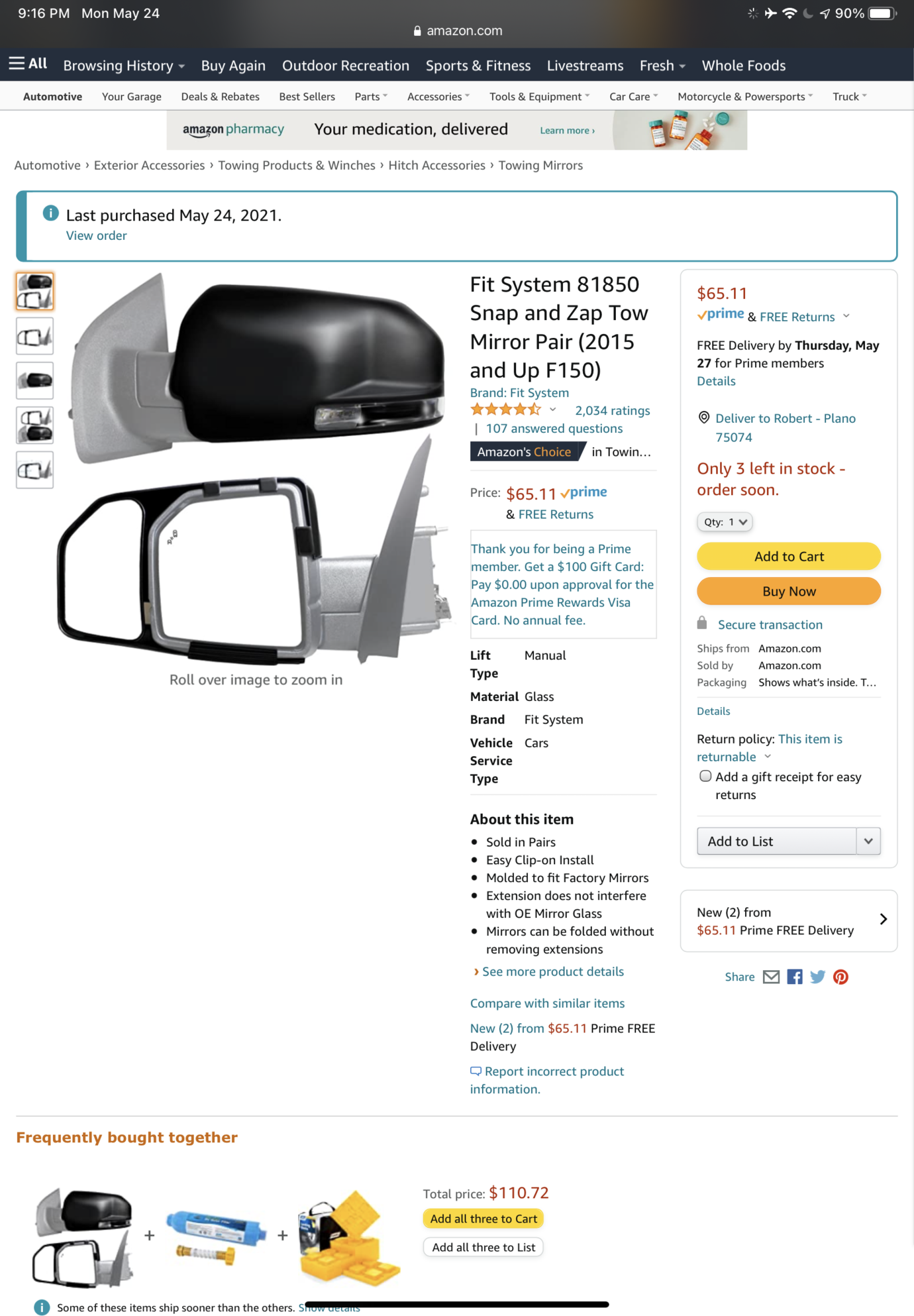

I ordered these extensions. They might not be perfect, but they had decent reviews. The boat will mostly live on the lake, so it will be rare to need to tow it...unless for warranty work or a major repair.

You will be happy with the clip ons, I have them for my 23' travel trailer and do just fine. I did line the inside with blue painters tape, I was worried they might scratch my chrome mirrors. No issues after maybe 10 uses.

Those are some of the better clip-ons that I have seen. Far too many clip-ons are no good, they vibrate in the wind and don't really let you see anything because they're shaking too much. If these are pretty solid while towing then you'll be okay with these.
