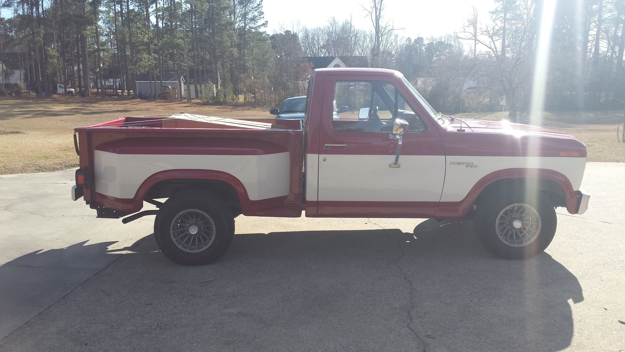

I guess I did not read that part
I think in the first picture the rear is to high for stock but all makes (GM, Dodge, ETC) pick up sit high in the rear and as said when loaded would level out.
81 F100 stock suspension
Dave ----

Dave G. - thanks for the reference pic. did your truck have anything substantial in the bed at that time? I agree the back end of my truck sits notably high, I was asking about the stock leaf springs for that reason. Might be fun for me to install the lift blocks in the rear when I do the shocks, gotta figure out the carb first though, after sitting for a week and maybe a change to cooler weather it is not acting the same at all and almost undrivable the other day!

No all that is in the bed in that picture is cardboard going to the dump.
Truck is used for weekly trash run to the dump but also take it to work, 37 miles each way, when I feel like.
The rear springs are what I thought were the best used set from 2 trucks when I was rebuilding the truck.
So I dont know what they have been thru but I would say they were factory, not replacements.
