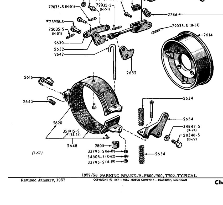

I have been away with work for a bit and was able to get tinkering with park brake on the old farm truck last night now that I am home. I have called around and no one can cross reference the bolt number in the picture 2616. The one I have is incorrect, I believe someone just stuck something in there when we bought it as it shoulders out before it is properly adjusted. Anyone know the specs on this bolt. I'm sure I can find something locally if I knew what to look for. It's for a 1964 F350. this brake assembly is a bit different but the band is identical and it was the best picture in my parts manual. I checked and the bolt is the same P/N for the 64.

Bolt is listed as 5/16" - 18 x 1 3/4"
Part number is 01T-2616
Sidney at NOS Only in San Jose shows one in stock if you wanted to check how much he wants for it.
