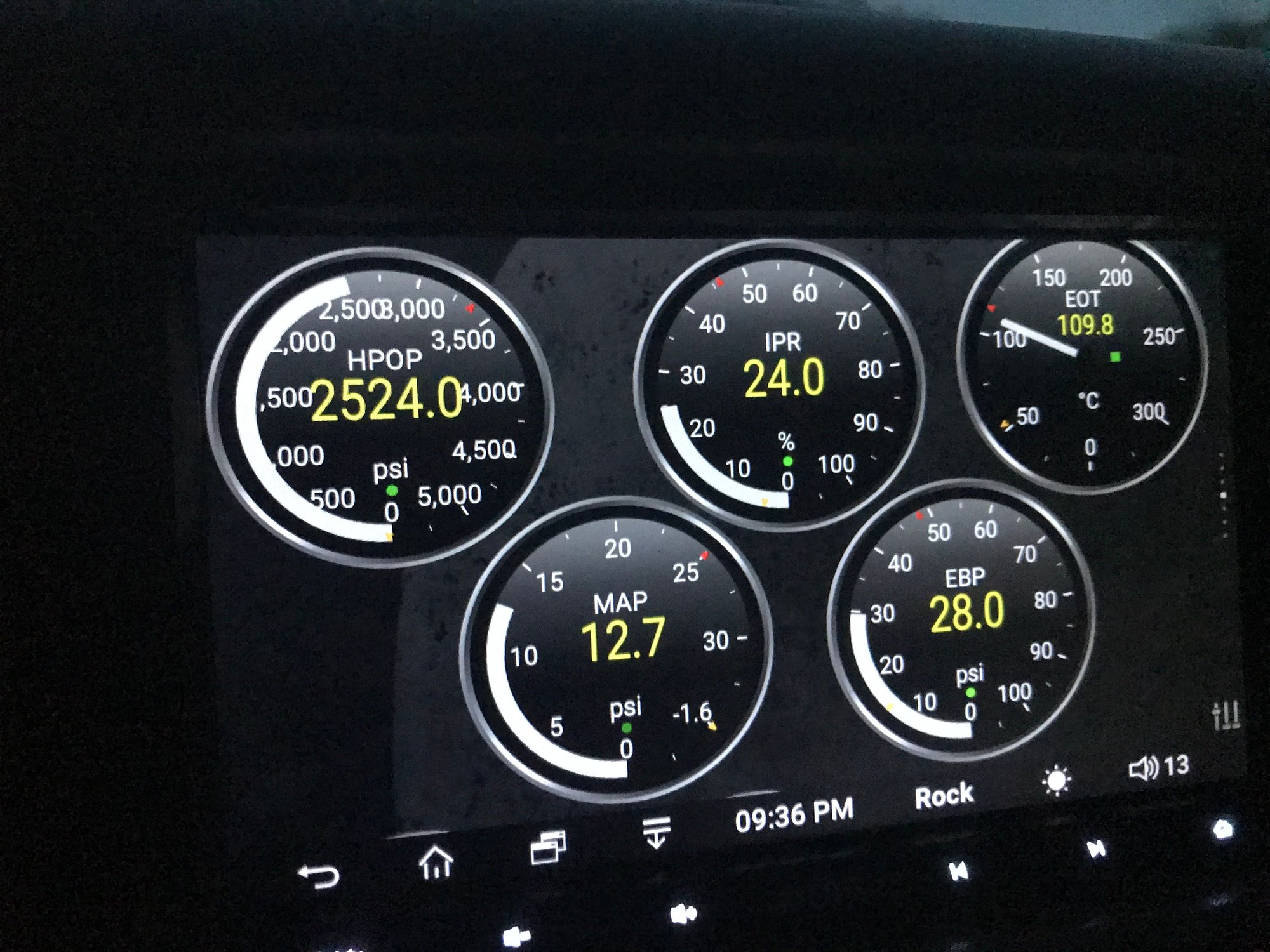

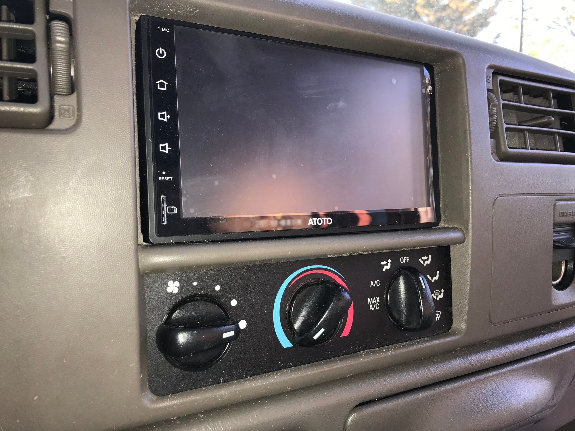

Originally Posted by muddslinger48
What’s y’all’s recommendation? I prefer the old school analog gauges as well. But it looks like the cts monitors ICP, engine temp and a lot of other parameters.
I am not saying this is your solution, that is up to you to figure out. But, I went with dedicated FP, boost and EGT (ZF6) gauges on the pillar. Then, because I don't like tablets, phones, screens or distractions in my face, I installed an Android head unit that runs FORScan Lite with the touch of a single button.
Details here: Android Head Unit Project...
Some pictures from my install here:
^^^ View of interior from passenger door.
^^^ The home screen of the Android head unit. Buttons from left to right are Phone - Radio - Web browser - Settings - Pandora - FORScan Lite - Google Maps.
^^^ These are my "typical" gauges I run when I want to see what the PCM is seeing. I don't normally run these gauges, but if I want to I can have them up and going in ~2 seconds. No need for constant monitoring or anything silly and unsafe. Just there if I want/need them.
Having the onboard virtual gauges via the Android head unit allows me to create videos such as this one where I can diagnose, dissect or monitor what the PCM is doing/seeing from the comfort of my home.

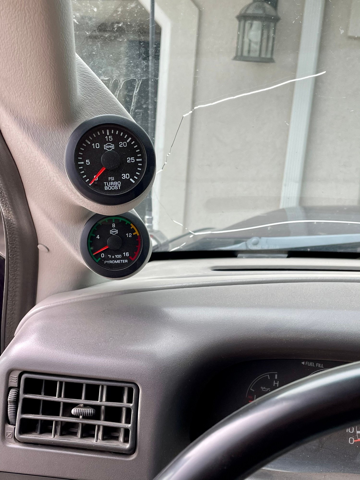

Very happy with my Isspro gauges (yeah time for a windshield lol). Helped me track down a boost leak recently.
I wanted the Edge at first but wasn’t a fan of how it suction cup mounted to the windshield.
Keep us posted on whatever you choose.
