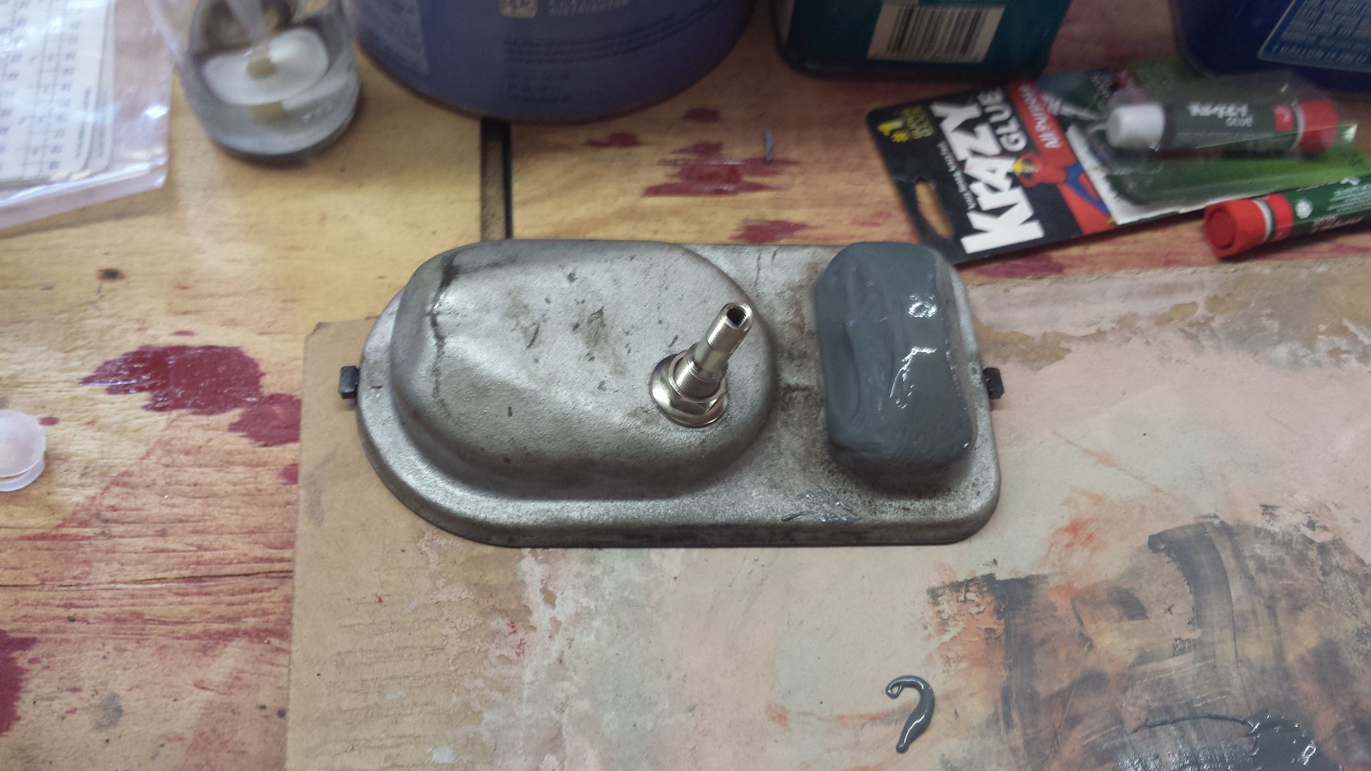

You can buy a pressure cap for bleeders that fit that master or make your own like I did.
I also made my own bleeder from PVC pipe and some fittings
Worked vary good on my truck.
