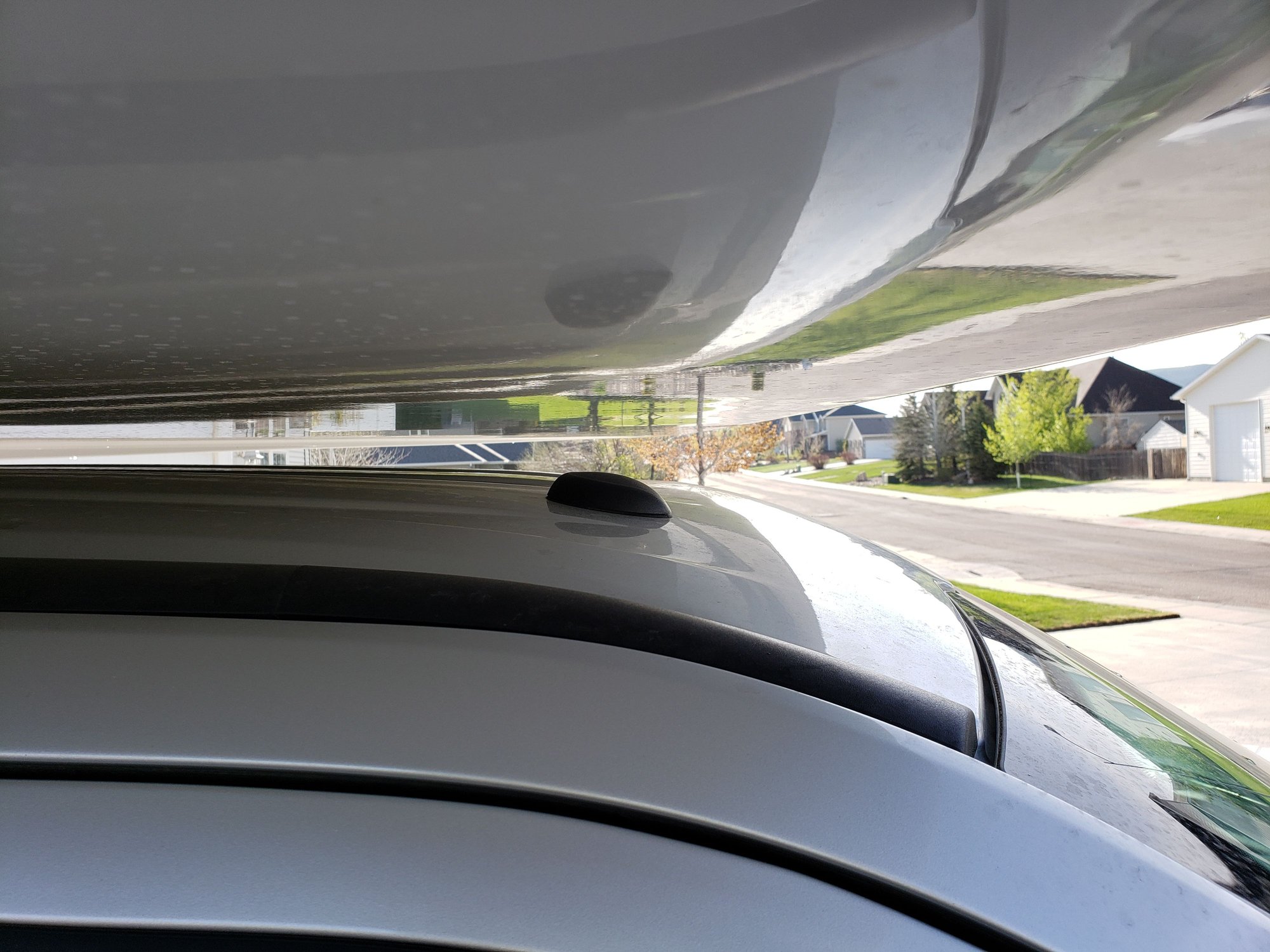

At the center of my cab, which is the narrowest gap between the bottom and the camper and the top of the cab, I have right a 2 inches of clearance. You can see from the photos that my SiriusXM antenna at the from of my roof is not a factor at all and the rear of the roof is completely clear of any antennae.
I use two, 3/4 inch horse stall mats cut to fit my bed sitting side by side and then my standard bed mat on top of those. Since I put the horse stall mats under my standard bed mat I have had no issues with the camper slapping the roof of the truck going over whoop-dee-do's going down the highway

Excellent!
Thank you for the pictures. Ours was definitely 4-5 inches of clearance. I think the dealership wanted to get rid of us quickly since we found a birds nest in the AC unit and other minor things we made them fix before writing a check. Hope we run into you someday out fly-fishing on a river.

Great photo's Wyo. Thanks for taking the time to post them.
