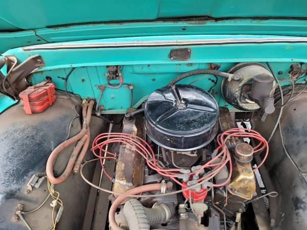

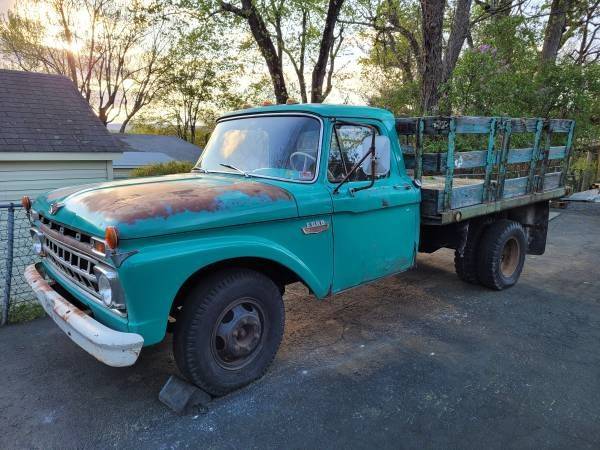

I know this sounds stupid but does anyone know what kind of engine this is. 65 f350. The guy thought it was a 272 . I’ve never heard of that nor could I find any examples of this truck having that.

Ford FE, 352 if it's original.. Really cool truck you have there.

The 65' F250's at least came with a 352 which yours looks like including original color.

Its a 352 being a 65. The 292 was last used in 64. The 352 was the standard engine used up through 77? with the 360 & 390s being options. The 360 replaced the 352 in the 70s as the base engine I believe. I had a 75 F350 super cab with the 390 tow package. 1977 the 390 was replaced by the 460, Good trucks

You have a 352, the 352 was 65-66 or 67 only, after that 360 and 390..

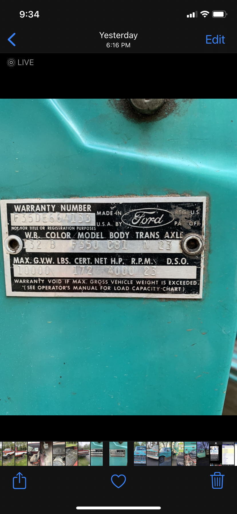

I looked up a decoder for that warranty number and it seems to be a 64. Made in the mahwa plant. That’s about an hour from where I bought it. That was the plant where for dumped all this paint in the water and lost a huge lawsuit to the ramapo Indian tribe. They made a movie about it Ford vs Mann

It was built in 64 as a 65 model. They start building new model vehicles months before the calendar year changes.

F35 = F350
D = 352 2V
E = Mahwah, NJ assembly plant
664133 = March 1965 assembly month, 1965 model year
132 = wheelbase in inches
B = Caribbean Turquoise paint code
F350 = F350 10,000 lbs. gvwr
C81 - C = Medium green crush vinyl and medium green ladder pattern woven plastic upholstery - 81 = 81B = Custom Cab
N = New Process 435 4-speed manual transmission 5N4AH
23 = Dana (Spicer) 70 5.13:1 ratio non-locking single speed 7.4M (7,400 lbs rating)
10000 = Max. Gross Vehicle Weight Rating
172 = Net Horsepower @
4000 = RPM
23 = Philadelphia, PA district sales office

that describes it to a T. I was looking at the decoder for 64 I think.
thank you very much. That’s one mystery solved.

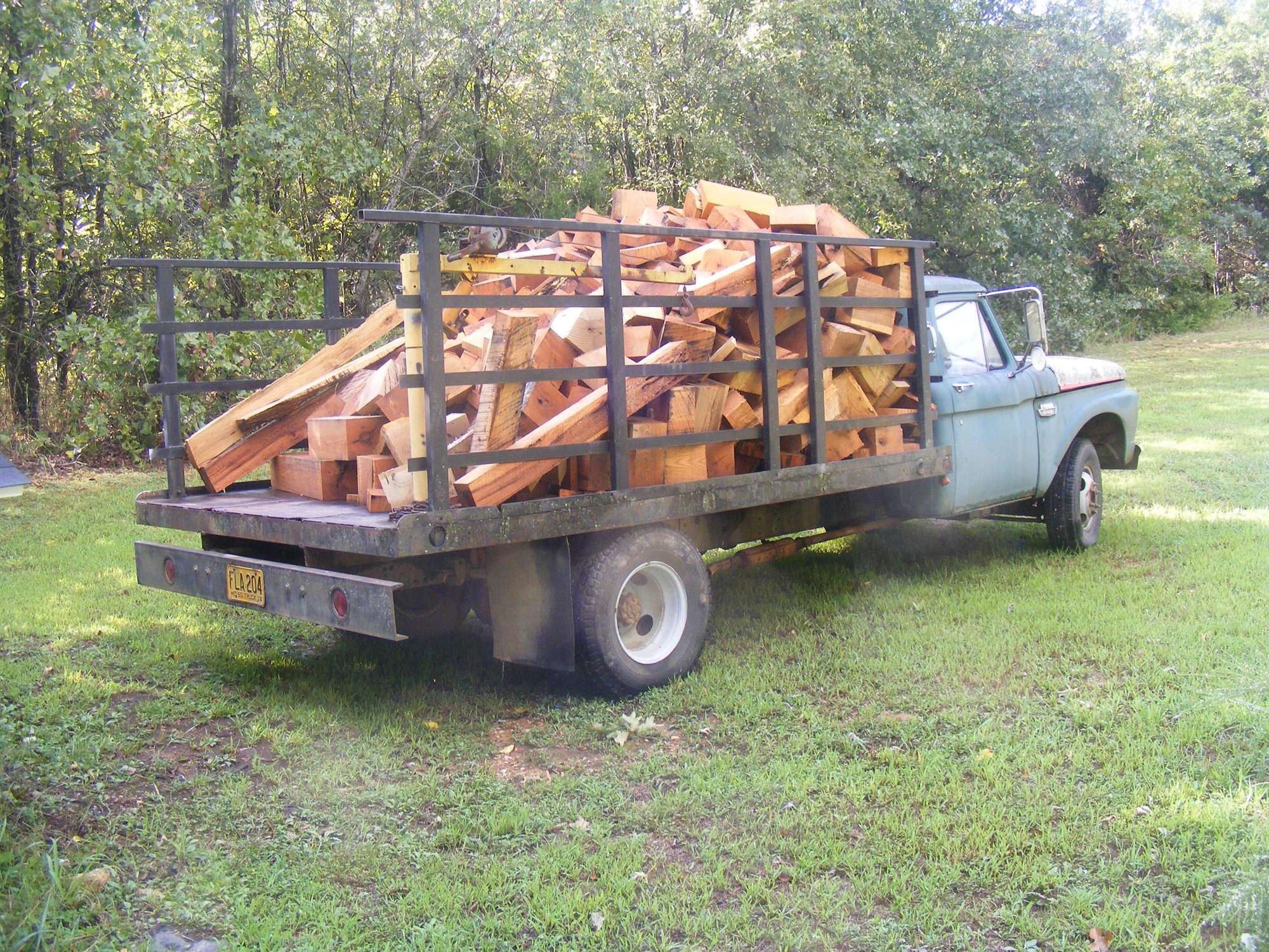

Your truck was made within a few days of mine which is the same color, and also has a flatbed... (s/n is only ~400 different) Mine was stretched by a previous owner about 2 feet. Also 4.88 gears and I added a brownie for over/underdrive.
As others have said, the original engine is a 352. But when I got mine 20 years ago, the owner told me it had been repowered with a '69 car 360. If you're going to buy internal engine parts, definitely check closely - all the FE's basically look the same from the outside.

That is a very nice original truck. I would love to have one like it with a dump kit. I've always liked those flat top valve covers.

I would also like to have a dump kit... throwing all that firewood down the hatch gets really old after a while
