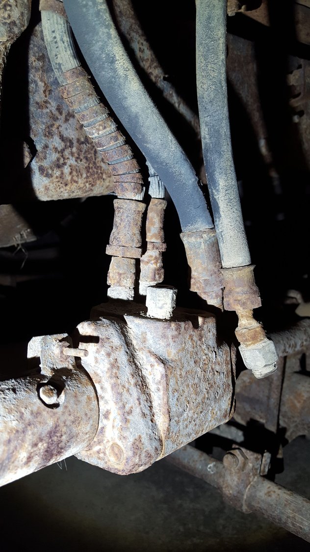

Thanks for your replies. So it looks like a previous owner removed the PS pump. I recorded a video - the steering shaft is turning going into the box.
With the power steering assist deleted from this truck, should the wheels be able to turn? I understand it might not be easy, but I'm turning the steering wheel as hard as I can and the front wheels are not turning, so there's no way it could be driven like this.
Unfortunately, none of my friends with trailers can help me in time. I looked into renting a tow dolly from various places, and they all have a 75-79" width limit between the outer edges of the tires. This truck is about 84" from edge to edge.
https://drive.google.com/file/d/1zTI...ew?usp=sharing
2 hydraulic lines that were disconnected by a previous owner.
PS pump lines not connected; no pump where it presumably should be mounted.
Thanks,
-Chris

Thinking now one or more of the king pins are frozen

Yikes, i see the problem now....... well when you get to working on that part of the mess, you can consider installing the newer style 78' steering or rebuilding the old valve/ram system..... sucks, both options are expensive and time consuming..

Is there anything I can do to get it moving just enough to drive around yard based on what you can see in the pictures or video?

Mmmmm, you should be able to get some movement out of it with the parts your missing, so something else is messed up, prolly in the gear box.... all bad news, sorry man.
