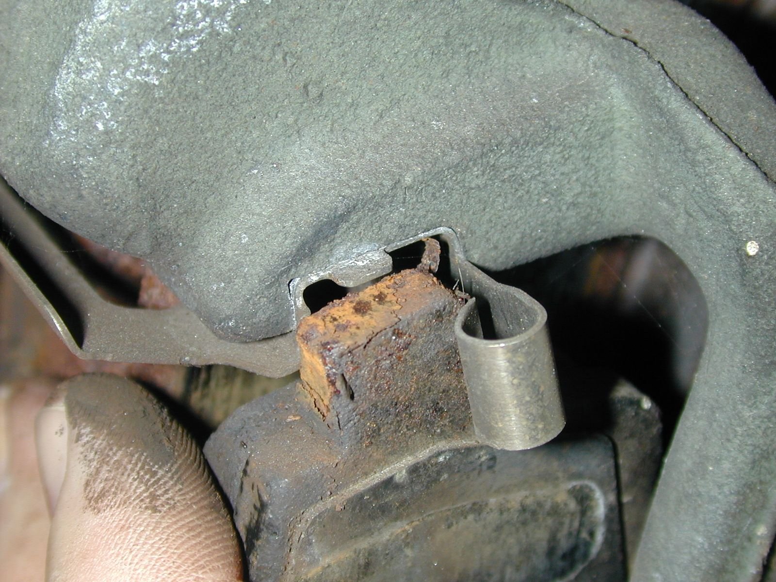

pulling while braking
I have found that rust will cause the pads to stick and I have had to grind the ends of the pads.which took care of the pulling.

Very much so. I didn't bring that up to Jim as he has replaced the brakes with new ones. But, we also found that with aftermarket pads often the stamped steelbacks were out of spec in the tabs, causing the pads to hang in the brackets. On any aftermarket build, the first thing we would do was check the pads for free movement in the brackets before the calipers got swung over.
Brake pads have a bad habit of rusting on the ends once the paint rubs off. Aftermarket pads also can have excessive paint, too. Once we had the pads moving freely in the brackets, we coated everything where rust could grow and take up the clearance with silicone brake grease. That included between the bracket and the stainless steel slippers.

Yes Ihave run into auto zone pads that would not fit in the bracket at all and had to grind them on the end and makethem fit. also I don't drive mine very often and have the issue after sitting awhile. Thank you for showing pics as Idon[t do photos;

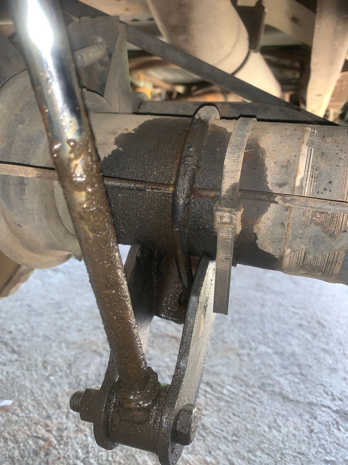

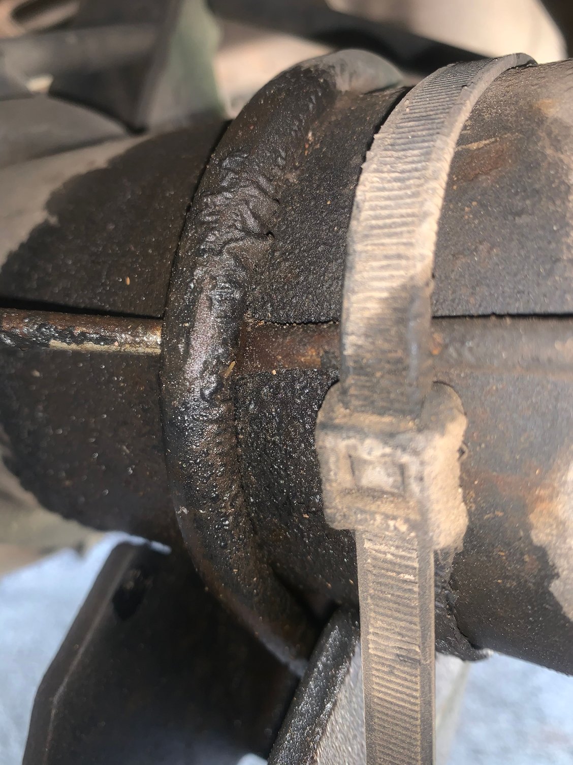

I had an issue with my passenger rear brakes not working and after over 50k I noticed the right side of the rear diff cover looked caked with dirt. My brake pedal started getting soft and I noticed a new drip from the shock mount and found the hard brake line was being pinched by the rear shock mount u bolt. I guess the previous owner might have had some work done and they accidentally put the u bolt over the line and it finally wore through.

My rear hard line rusted through where it's clamped on top of the differential.
