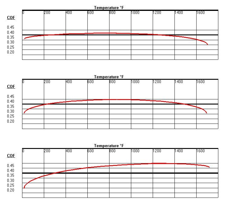

A rotor will have varying temps based on its radius; that's normal. This is why you always take rotor spot checks at the same location. How quickly you take the temps side to side or front to back also alters the values. Front to back axle depends on driving history.
Whether a friction material had higher friction or lower friction at different temperatures depends on the formulation, iron in the material, or other components. Every friction material has a bell curve to the coefficient of friction based on heat. Cold and excessive heat (fade) will be lower in friction.
A good, Passenger Car Ceramic (organic) or Light Truck Low-Met material
A good OE Semi-Met Light-Medium Truck material
A Medium to Heavy Truck or Racing material
What it sounds like, though, is at least on that axle, there is a differential in clearance pads to rotor where the right has less clearance than the left, so there is a minor heat build-up until enough braking activity where it settles out when "warmer" or thermally soaked.
No way to really know unless there was instrumentation on the vehicle. Pulls are usually felt from 70 to 100ºF, but mostly at 100º.
