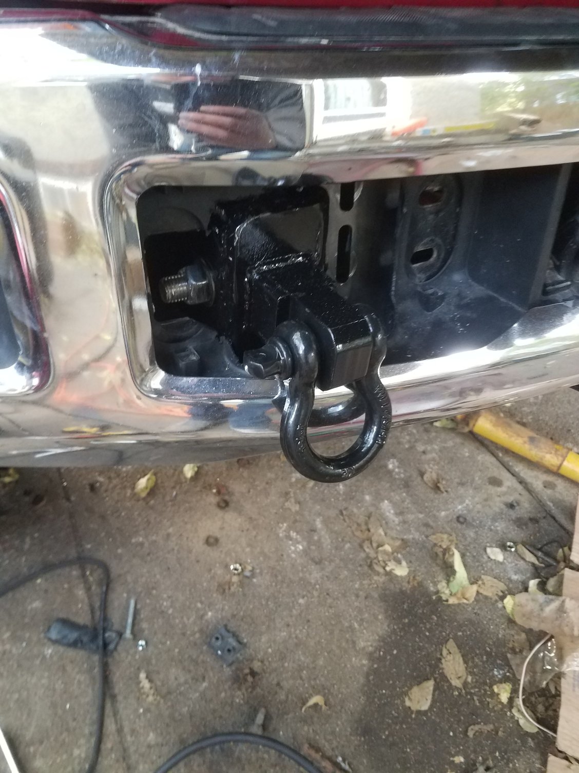

I threw some generic HID projectors into the valance on my Flareside. Turned out pretty nice. I threw a 2017 bumper on one of my other trucks with the Morimoto LED's they're nice. I think I would look into the bumper swap, it's easy to do and looks great.
Two questions: What light bar is that, and how did you mount your tow hooks? Looks good!

Thanks Toork! Light bar is a Rampage if I remember correctly. The tow hooks for a 2" receiver that I welded into the frame along with a grade 8 3/4" bolt going through the frame and the RSK frame. Then welded on "cover" plate to make it look nicer. PS the bracket I received was pretty flimsy for the bumper so I welded on some 1 1/2 inch angle iron to stiffen it up.

You also have to flip your license plate bracket around to fit light bar above it. One last thing, an o ring or grommet will keep the tow hook from slapping your bumper. Hope this helps!
