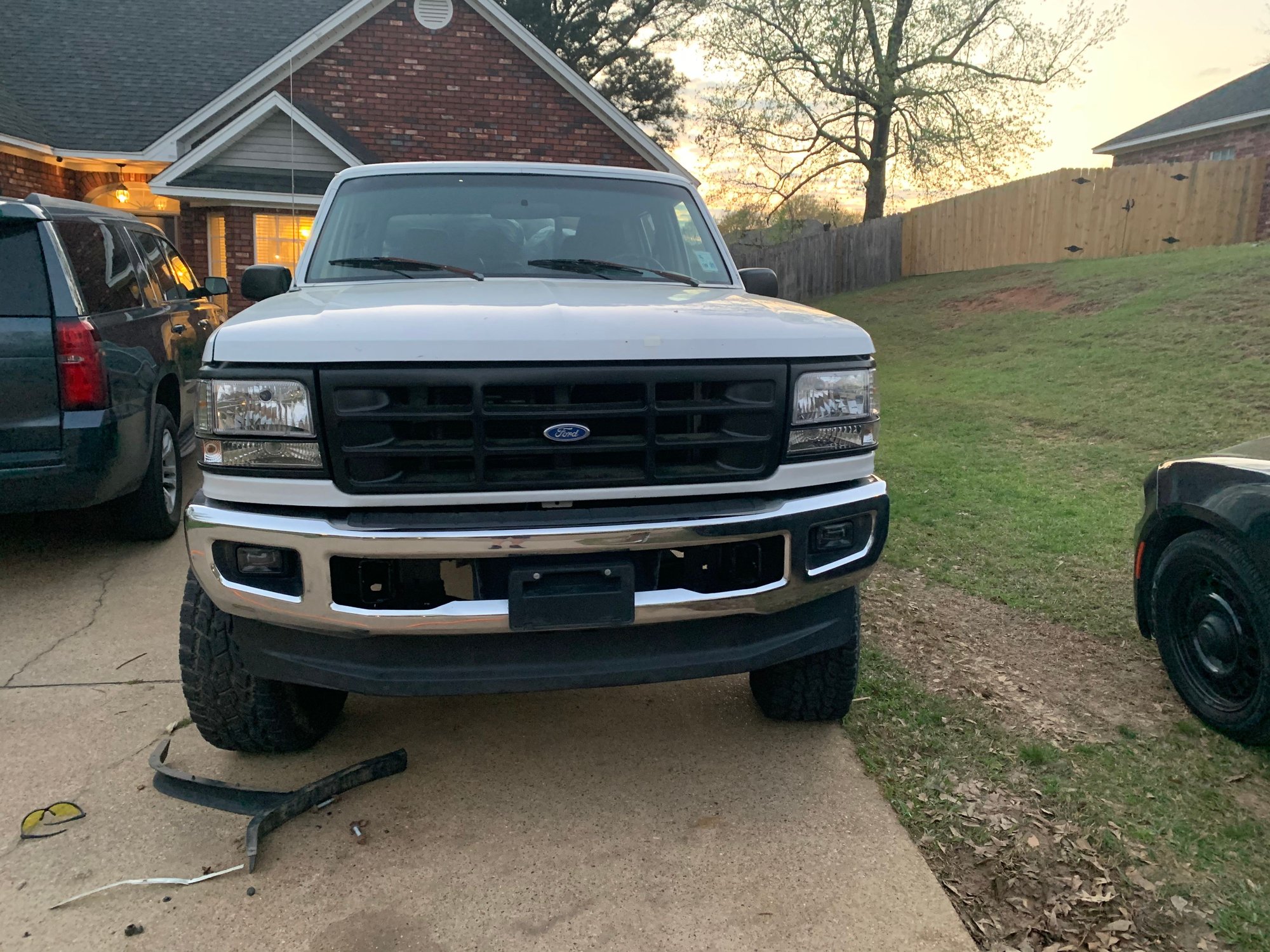

2019 f250 bumper CPAddicts mounts..... 😅 haven’t wired up the dogs yet though. They are Mishimotto.

Toork, what LED bulbs did you use for your headlights? I think the bumper conversion looks good on the 250 and the 350s. I don't think those bumpers would look right on my F-150 Eddie Bauer.

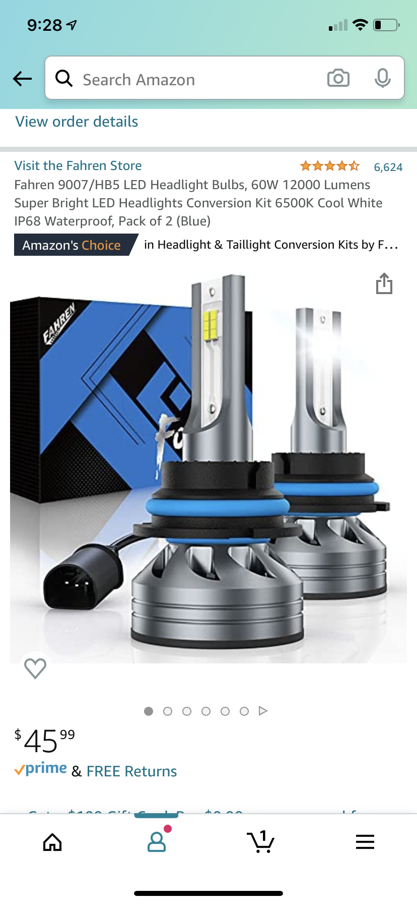

These:
placed in new replacement glass. They are super bright.

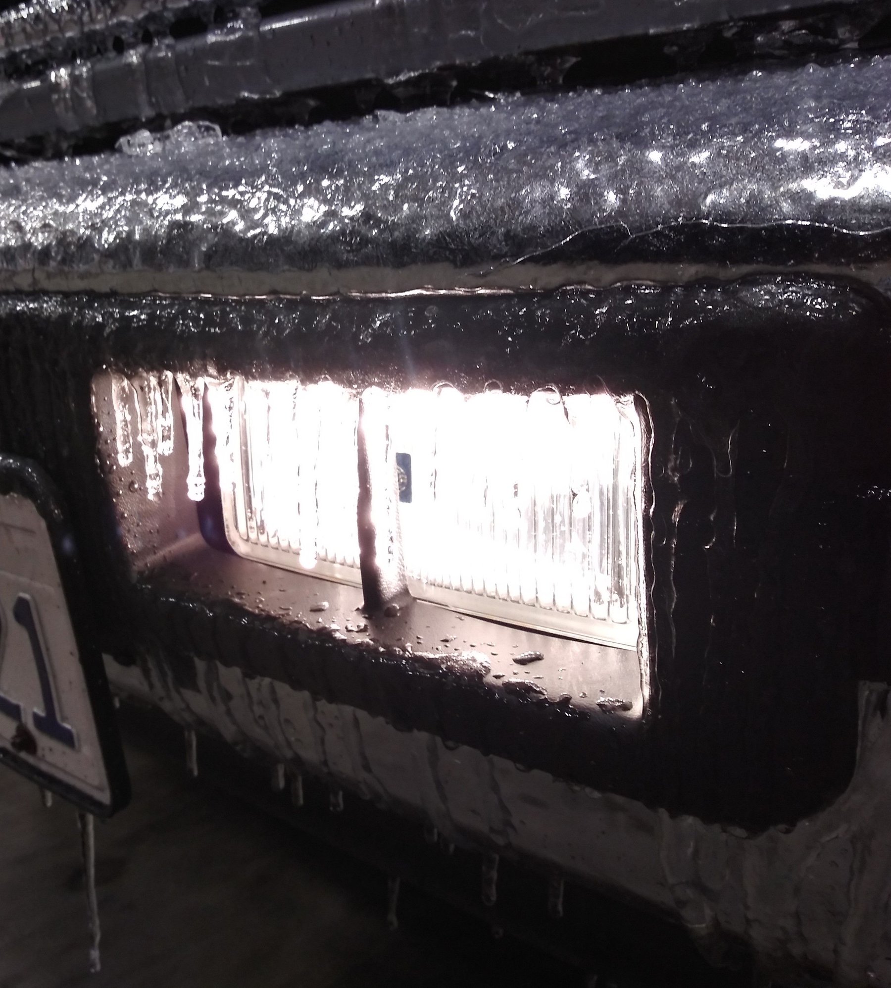

Hella 550 series work the best and look factory. They are available in clear fog, amber fog, and driving for use as aux high beams. They can be mounted with home made brackets using a flat bar with holes drilled in it. Wouldn't go with anything else.

There are currently no LED headlight bulbs that are suitable for use to replace a halogen bulb and none are DOT approved since they do not produce a good beam pattern and just create excessive glare.
