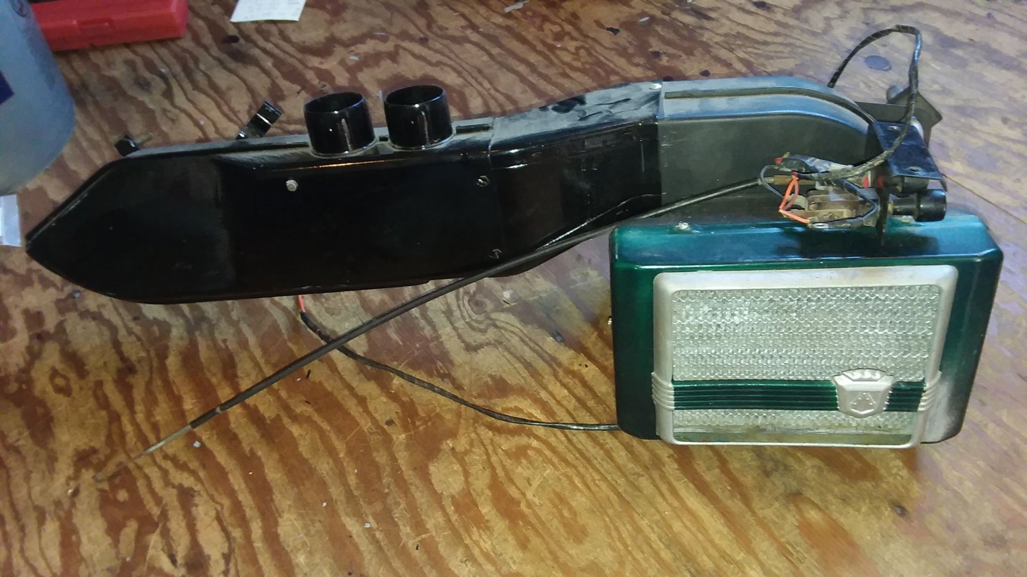

What year heater unit is this it came out of my 1955 F-100--will duct work fit 1956 F-100 want to know before I sell it -- going price-- sell as a unit or separate duct work and heater unit separate--- Thanks

56 duct is different

Any chance you know the difference, is the heater part the same or did they have different company's making them-- Thanks

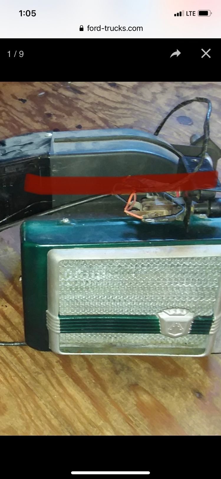

I don’t have one in front of me but I seem to recall the heater core sits higher on the assembly on a 56.
The red line is approximately where a 56 core sits in comparison to the main housing

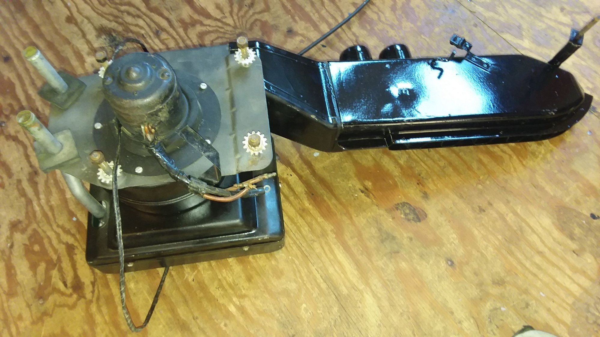

This is a 56 heater assembly

Thanks for your help-- there is a big difference and defrost outlets are at a different location--

Yep, also 53-55 6volt, 56 12 volt. Say, did you get the last PM about your paint code?
