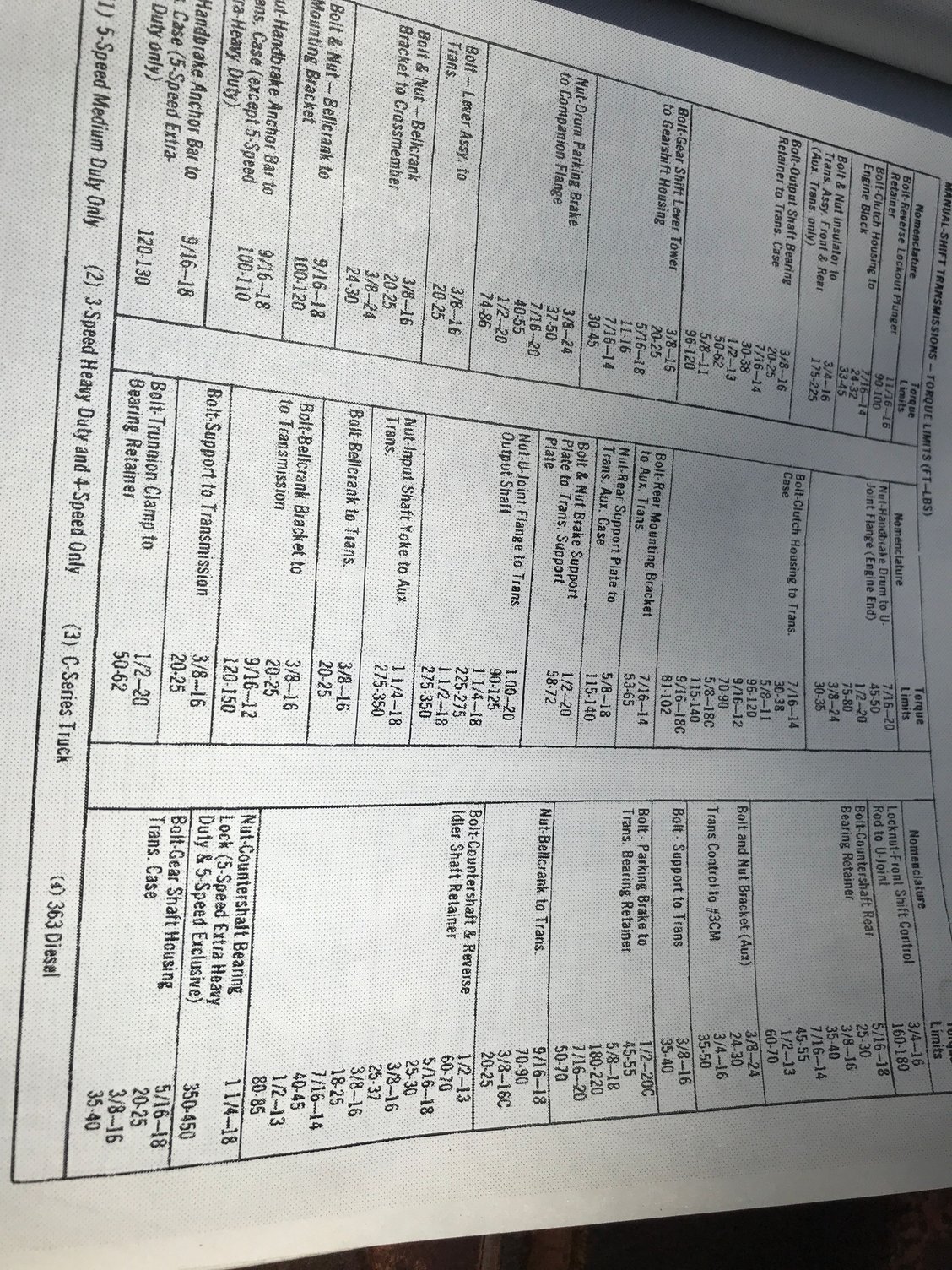

is there a torque spec for transmission to bellhousing? I have what I need for the clutch. Im putting clutch and trans on my 390 and putting it in the frame today. I seen some specs on different BHs but nothing for the FE engines. Its something I can finish off later. I definitely need to just get a shop maniual sine I have a few of these trucks. Thanks for any help.

I don’t know if this will help. This is from the 69 manual, looks like bell housing is called bell crank?
78 manual, looks to be like the 69 manual

Works for me, thank you

Clutch housing to engine block. 7/16x14 33-45 ft lbs
