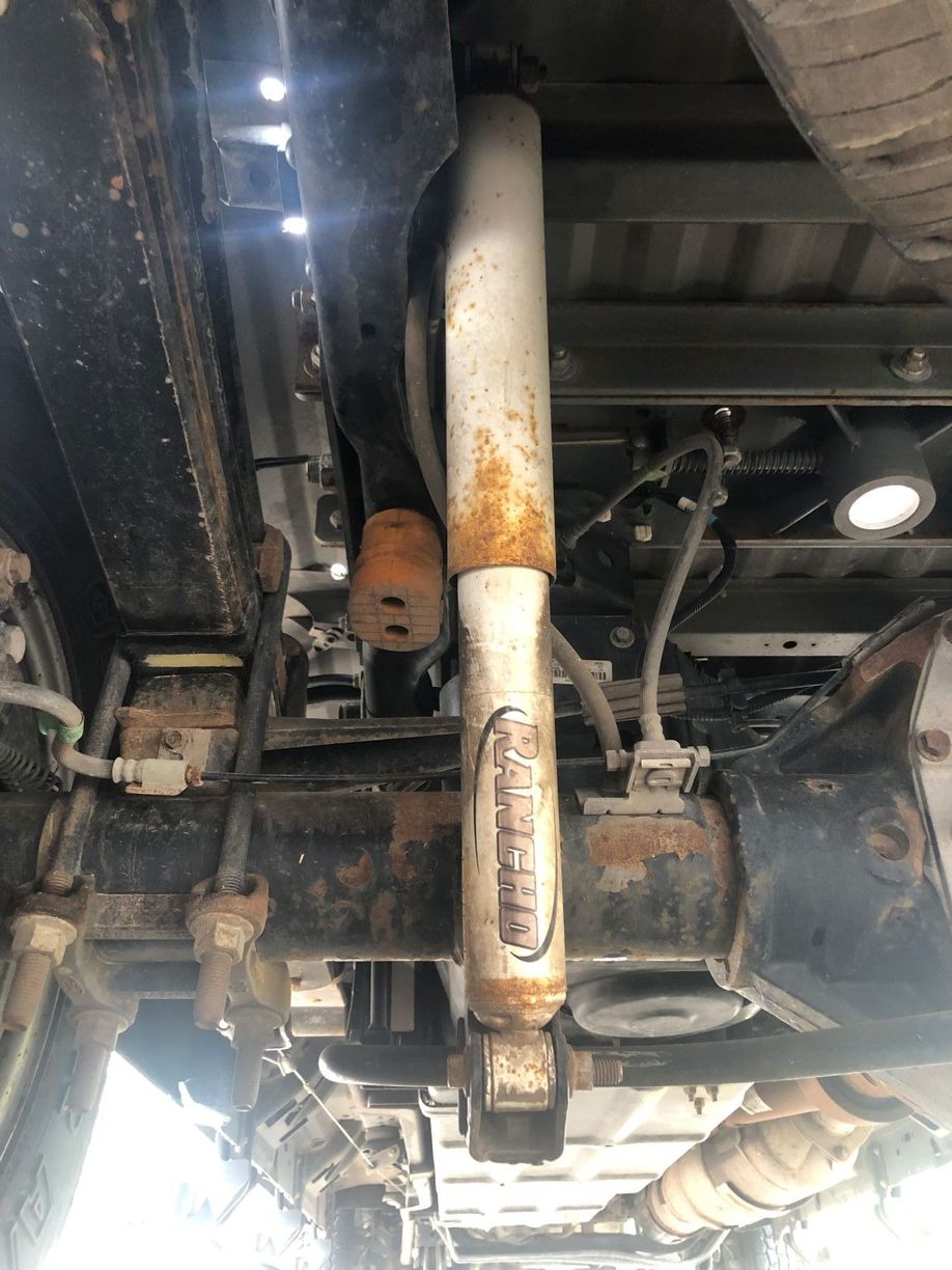

I am looking for recommendations for shocks. I don't know if the current shocks are stock or not. Truck has 117K miles. Truck is used as casual driver with frequent 5th wheel towing. Truck does NOT have a lift/leveling kit.
My understanding is that the rancho's are terrible, that's what I currently have.
front
back
I see lots of references to the Bilstein's. Is there a difference between the two 4600 vs 5100?

Those looks like the stock FX4 package "Rancho" shocks. They aren't even real Rancho's, they are Ford parts that are painted to look like Rancho's.
I recommend the Bilstein 5100's. Very reasonably priced. I ended up getting the whole kit from Amazon for <$350 if I recall. MUCH better ride than the stock ones (mine had 110k on them and a few were blown out).
From what I could tell the 5100 and 4600s are the same, except for the coloring. I preferred the silver/black of the 5100 to the blue/yellow of the 4600.
