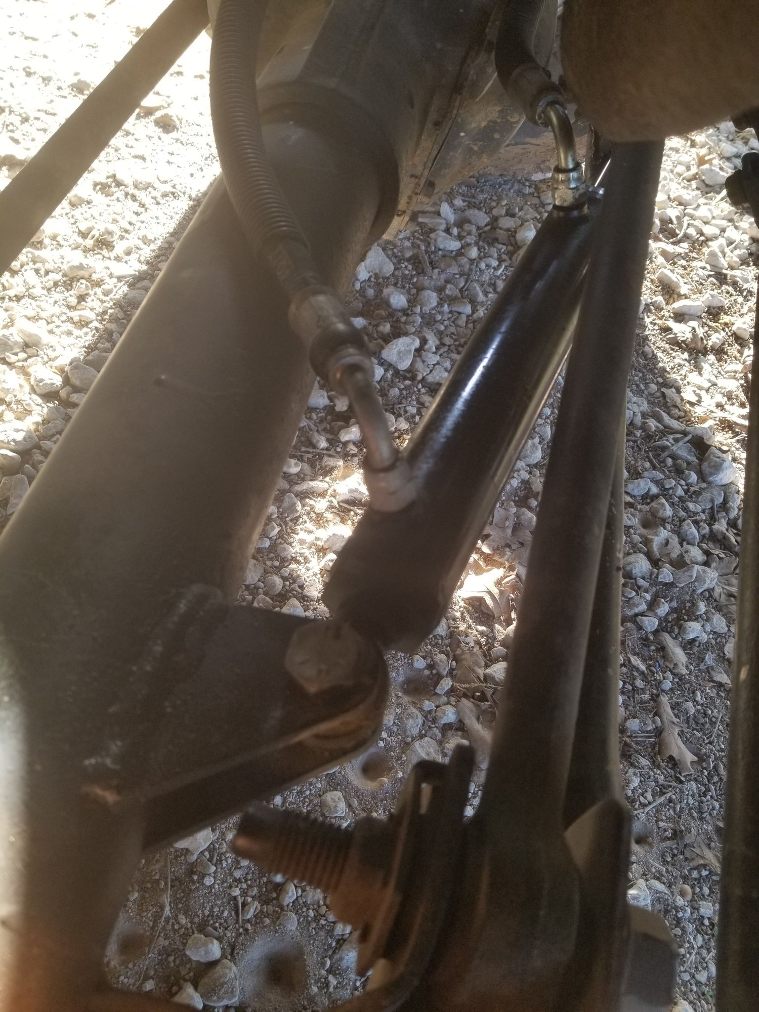

My output shaft broke on my box. I wanted to ensure that didn't happen again after seeing others having the same issue. Hydro assist from West Texas Off Road pictured here. I chose to weld after warnings of the bolt on clamps slipping and the diff cover mounts not being up to the task. I know some who do run those mounts without issues though and if you're not wheeling it, you may be okay.

I’ll have to give the axle a good look to see how I could mount it near the base of the trac bar. Ive got an 06 front axle so a little different then the pics shown. I assume 1/4” plate would be plenty for the tabs on the axle housing?
