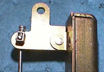

I'm using bear claw latches actuated by a 1/8" rod pulled by the door solenoid . The assembly looks like this
the little Rube Goldberg looking clamp on the rod isn't doing what it should. It was fabbed from a electrical cable clamp cut in half. The problem (I think) is that is copper and tends to loosen and fall off... I can't get enough torque on it with the screw head. I need some kind of rod clamp that is small enough to fit between the latch arm and the inside door skin and clamp securely to the 1/8" steel rod.
maybe something like this or similar to a ground rod clamp but much smaller
I can't find a source for tiny stuff , just electrical and mechanical stuff... any suggestions ?? I have about 3/8" stick out on the rod thru the latch arm

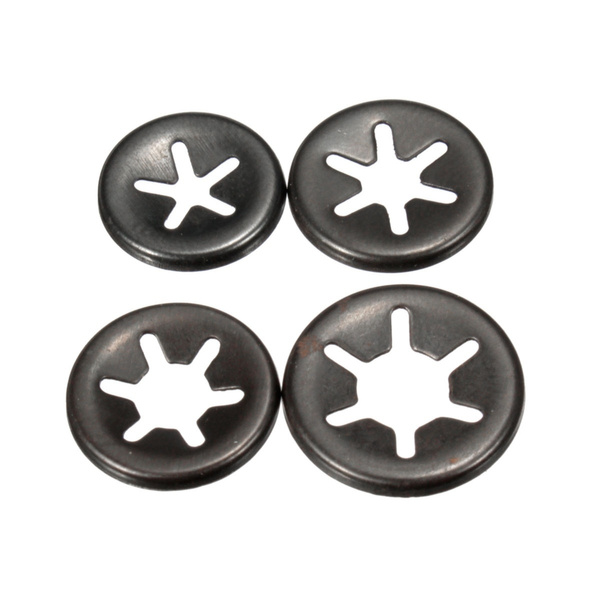

You need something like this, just pushes onto the rod..
push on washers
https://www.grainger.com/category/fa...aining-washers

What John suggested or these which is what many factory latches use .
of course the rod and hole in the latch need to be the proper size . The plastic will also help with any rattles the metal on metal produce .

Exactly what I would use. The factory made sure the tip was mushroomed to prevent the rod from pulling back up.

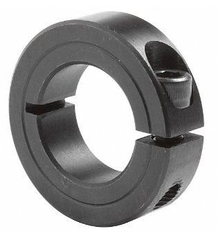

Try McMaster Carr look for set screws, be sure to scroll down to set screws and look at the ones with serrated heads
Locking Collars | McMaster-Carr

I couldn't find a shaft size on any of the tailgate rod keepers and the ones at LAP store were too large. I ordered 4 of these yesterday evening Should be here today... couldn't find push nuts locally in size needed and ship time was longer than MC
