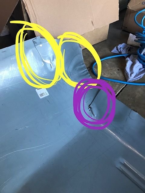

Somewhere in my build thread I have pictures of my tabco panels. Yes I had a wrinkle at the top of one curve and I had the ugly fold over flap on the driver floor board. I also called Tabco to ask why they did that... and boy was that the wrong thing to do. You'd've thought I slapped his momma. Long story short he does things the "right" way and every one else is cheap. (His words not mine). Ultimately I am happy I used them though. They are original thickness and thats definitely an area I do NOT want cheap flimsy metal. Also I cut off the wrinkle area as I didnt need to replace that section so that was not a problem. The overlap fold, I just cut the excess off and welded up the seam. All in all a small amount of effort to make them look like original AND you get the true thickness... worth it to me. Ill see if I can find my photos and link them.
Edit
first picture is the in question parts of the tabco panels. Yellow circles I cut off because I didnt need to replace those parts. Purple circle is the one I delt with. Again cut off the overhang part and just weld up the crack thats left. This link takes you to me installing the driver side patch panel. . Passenger side, I cannot find a full photo for, but it had zero overlaps and I think MAYBE one wrinkle at the top left of the footwell.

You only get what you see. The others sound perfect. Try one of them out. I cant say that I have tried any of the ones you were referring to. I did use the tabco floors and had no issues but I did not use the full pans. So, I did not have to hammer the crap out of everything. Make a choice and weld them in. I doubt any of them would just drop in. This is the only picture I have from before cutting to fit.
Mine were for my 72 though. As far as the cuts in them, once the angles are fit. You would make a cut and weld it.

Honestly... my "made in China to the USA" floor pans look better than those. Plenty thick and better quality imo. 90 bucks off Amazon.

Do you need to replace the ENTIRE floor plan? If not I would still consider tabco. Like I mentioned, all of the problem areas on my tabco panels got cut off because I didnt need the entire tub. If you need the entire tub, I think youll find issue with pretty much everyones panels so just buy from one and make it work.
