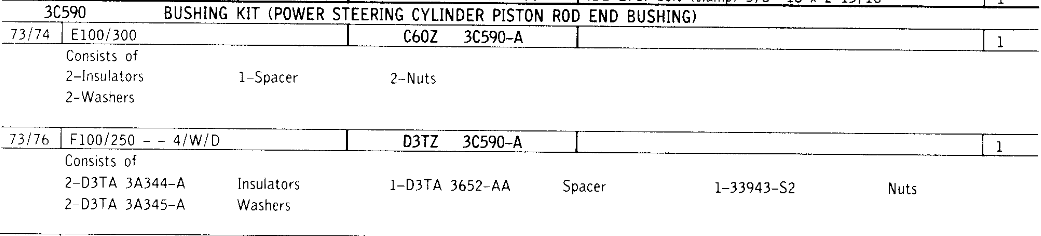

1974 F100 4x4 360FE, C6, np205. I have a power ram assist set up on my steering. I know the valve is a Garrison...
On the axle where the ram itself mounts, the rod on the ram has 2 rubber bushings on the end. They measure roughly 2-1/8" O.D. and the inner hole is 5/8" and are approximately 7/8" thick. It's where the ram attaches to the tie rod. Anybody have any idea where to get replacement bushings?

Here is a link to a kit listed on ebay, but it doesn't picture the washers or nut:
https://www.ebay.com/itm/38410562296...gAAOSwnPtgfma6
and others:
https://www.fordpartsamerica.com/oem...kit-d3tz3c590a
https://www.ebay.com/c/1325021818
https://www.bonanza.com/listings/For...m_id=124826054

Call Blue Top, the fella there is very helpful and dosent keep secrets, if he has some he will sell them to you or point you in the right direction.
https://bluetopsteeringgears-com.3dcartstores.com/
