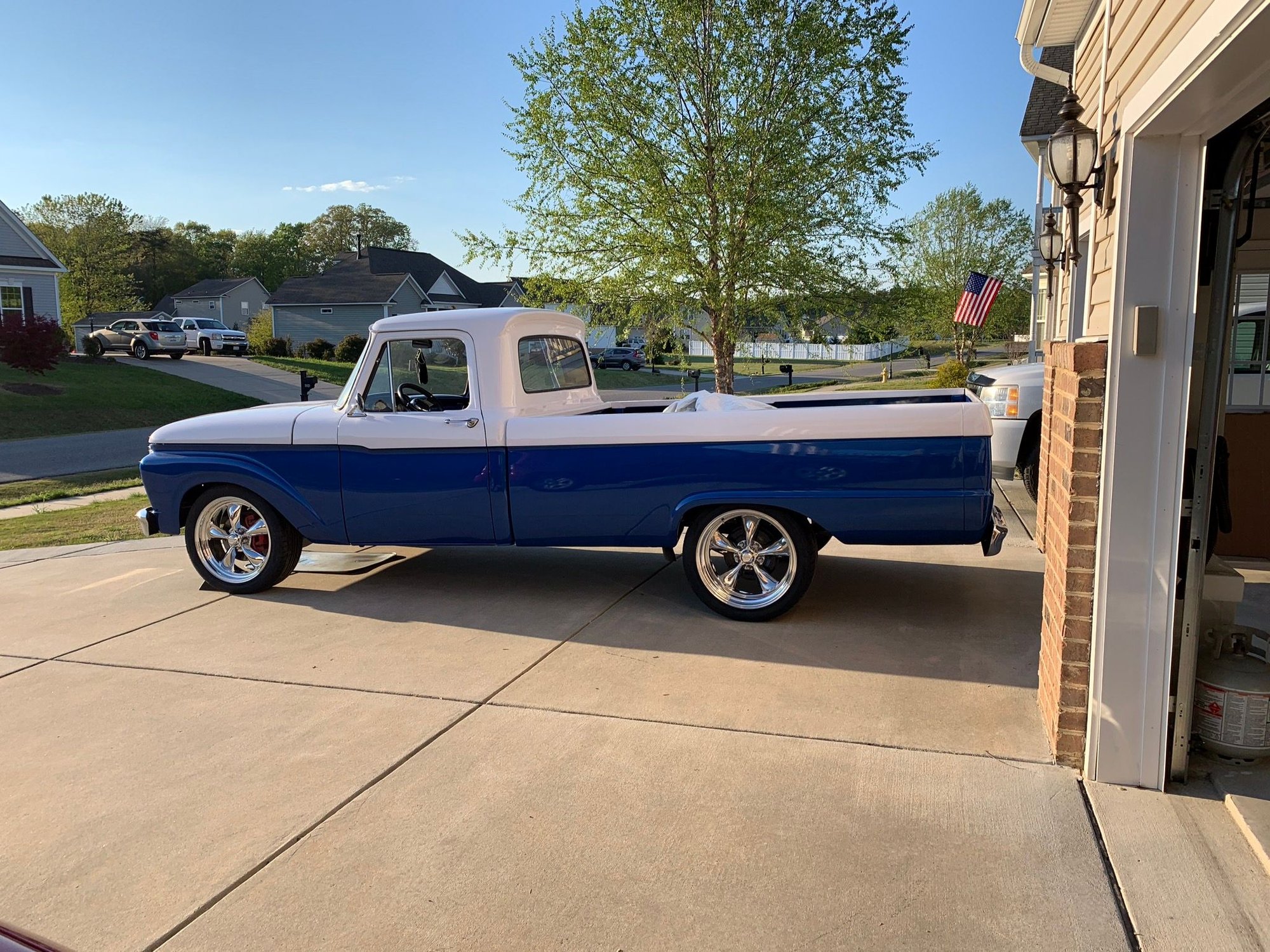

66 F100 update
It’s been awhile since I have posted any updates, today I finally received the new tires and wheels for the old girl, I’m very satisfied with how they turned out. Due to the CV front suspension and the original rear end I had to special order them to get the offset and lug pattern I needed, I wanted to eliminate the rear spacer adapter and get a custom pair of new shoes, since the pollen is crazy here I figured I would post a picture rather than turn it yellow by cruising around, that will happen this weekend.

Great looking truck. Do you have the specs for the wheels? Back spacing and such. I have the same combo of a CV front with stock rear and have been struggling with ordering wheels. Thanks in advance.

The wheels are 20 in American Racing Torque thruster II’s, I chose them because of the tire selection available, the rears have a 5x5 offset and the front is a 1”positive offset I am running Nitto 555 G2’s. American racing was the easiest to deal with but that being said it was still a 10-12 week waiting period because the were a custom wheel, I used a local tire shop in town and the owner has a history of custom builds so he did all the measurements because AR requires a custom build or spec sheet.
I hope this helped
