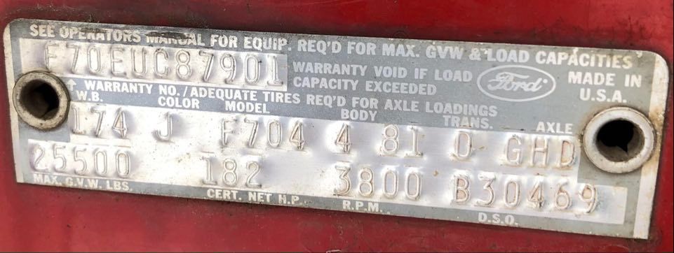

Hi need help decoding a trucks vin that I just purchased. Its a F700 and the owner claimed it was a 1969. Thanks!

Welcome to FTE! What does the title say? Does it match the VIN on that plate?
F70 = F700
E = 361 2v FT gas V8
U = Louisville Assembly Plant
C87901 = 1968 Series number
174 = 174 inch wheelbase
J = Red
F704 = F700 gas, 25,500lbs GVWR
4 81 = I don't have the docode for the upholstery or seat type. Looks like standard cab.
O = New Process model 541 five speed direct transmission
GHD
GH = Eaton model 17221 Two Speed Rear Axle / 6.50/8.87 / 18,500 lbs. Rear Axle Capacity.
D = Ford-Rockwell (Timken) 7,000lb capacity front axle
25500 = 25,500lbs GVWR
182 3800 = 182 certified net HP @ 3800 RPM
B30469
B3 = Ford of Canada Atlantic District Code
0469 = Special order number
if something doesn't match, let me know.

Everything matches thank you!
