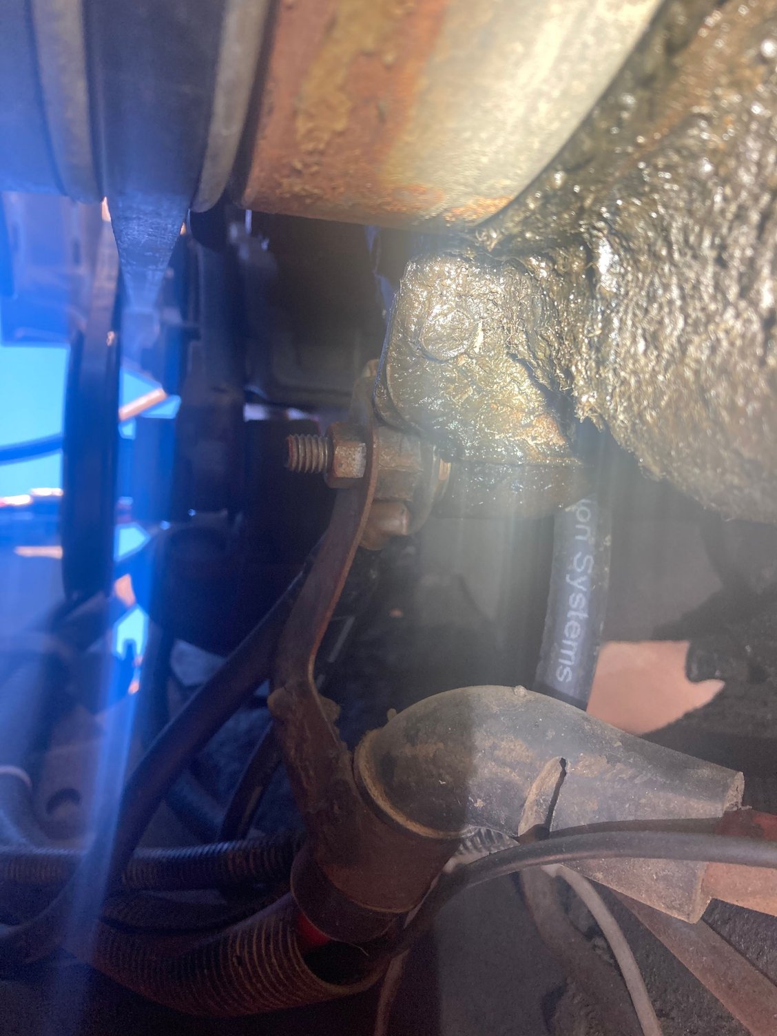

Hi folks,
I have 1994 7.3 ambulance van. Because here in Europe we have batteries that are longer that US batteries, I need to replace negative battery cable with bit longer.
Few months ago I take out original cable from the chasis make photos, but because of covid, I don't have time to replace it. Now I am little bit confused about order of the wires that need to be connected. Does someone of you can make some photos of the cable where and how is connected to the block?

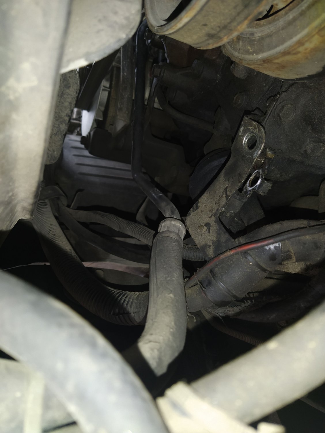

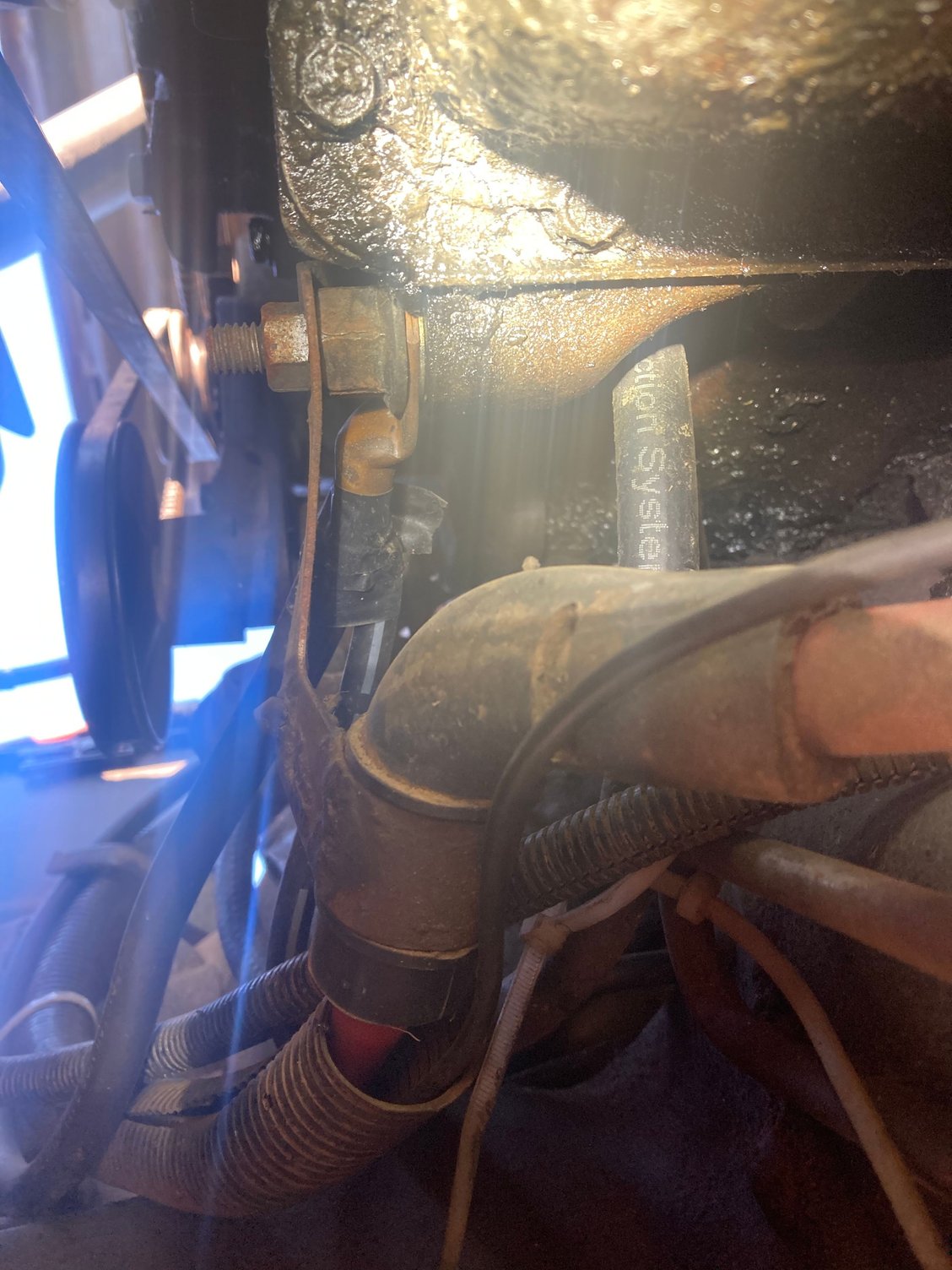

@Gjorgjija you probly already have this figured out, but if not here is pics from my engine. First pic is driver's side cable, second two pics are on the passenger side with that metal bracket that holds the wiring.

Thanks for the answer, but is not showing the pictures

now it's OK and clear. thank you very much
