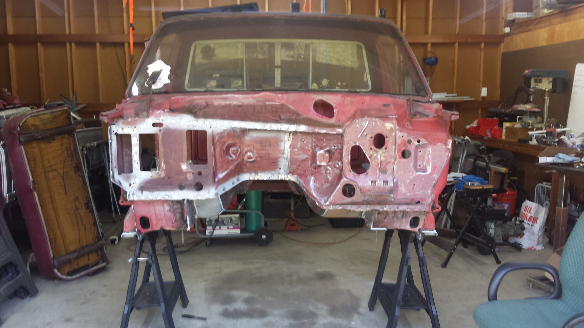

As the other Dave said if you can get the HVAC box that bolts to the firewall and the dash with the vents in the dash great.
Even better if you can get that AC harness and even better than that the cab harness or what is called the main harness as the AC harness would be plugged into it.
The AC firewall has 3 large holes that match the AC HVAC box.
The non-AC firewall only has 2 large holes that match it's HVAC box.
Non AC firewall
AC firewall
Yes I did a non AC to AC firewall swap so I could have AC. The cab the AC firewall came from was a roll over and could not be used other than what I used it for.
Dave ----
