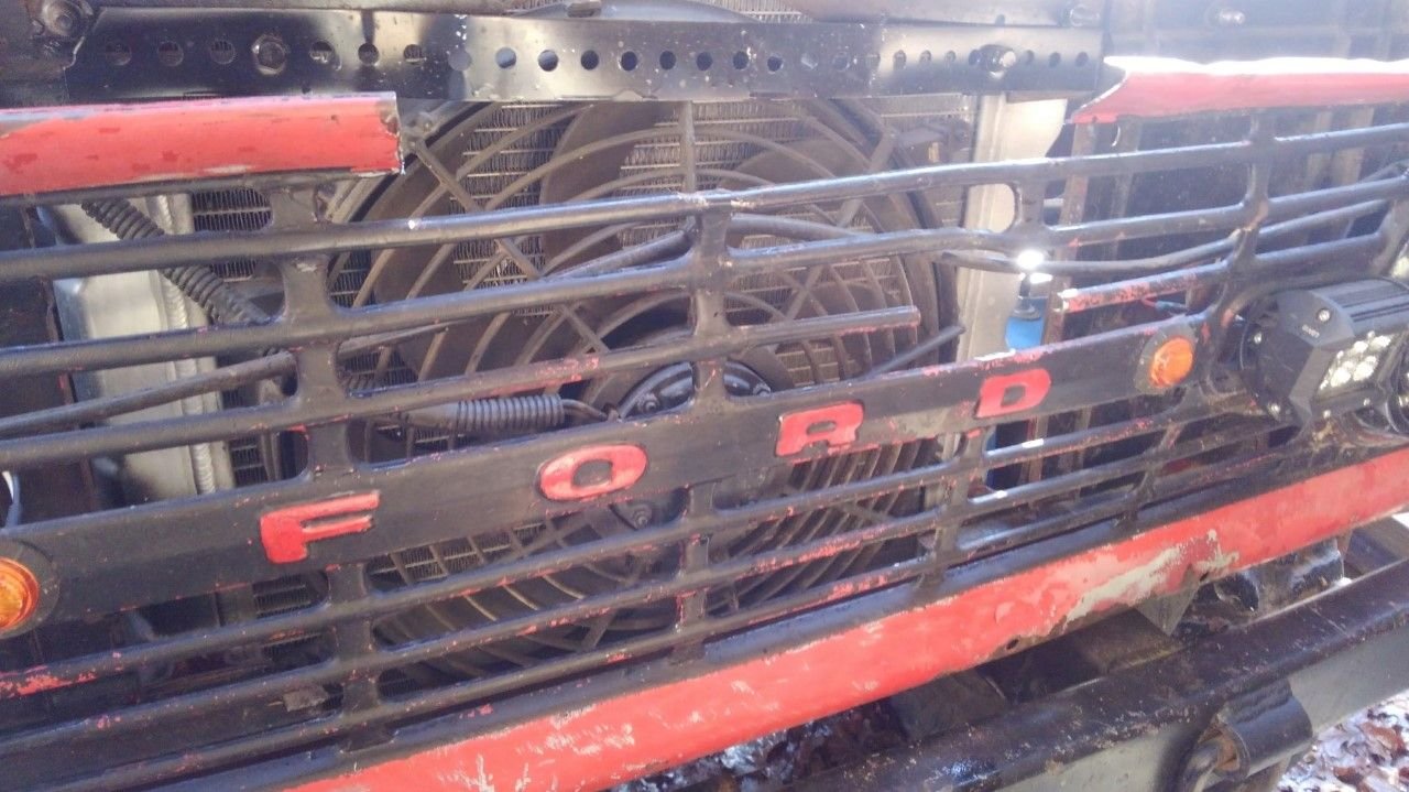

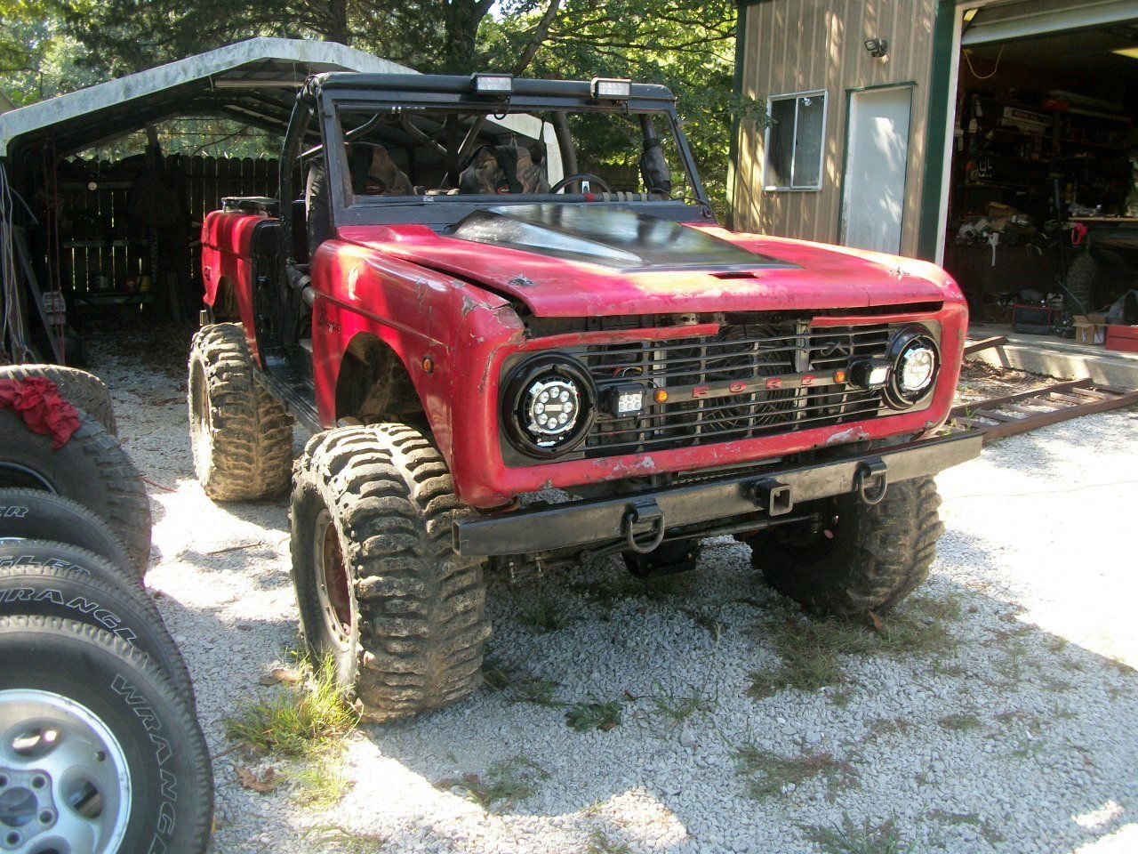

Ah yea ok, I know its blue and I know (knock on wood) I have not any leaks or corrosion problems and the radiator has had LOTS of low gear high RPM use. Then long periods (months) of setting dormant. Than back to hard use and I have had it so hot one time (like 220 +) and it did not puke. Also I do not run it thru a heater core. I use an electric fan that is set up (mounted) on the outside (front) of the radiator to pull from the outside and push thru the radiator. No shroud or fan on the motor. Also have a trans cooler on the back side of the radiator. I hope Murphy and his Laws do not see these statements and I just jinxed myself.
After a little grill patch repair work.
