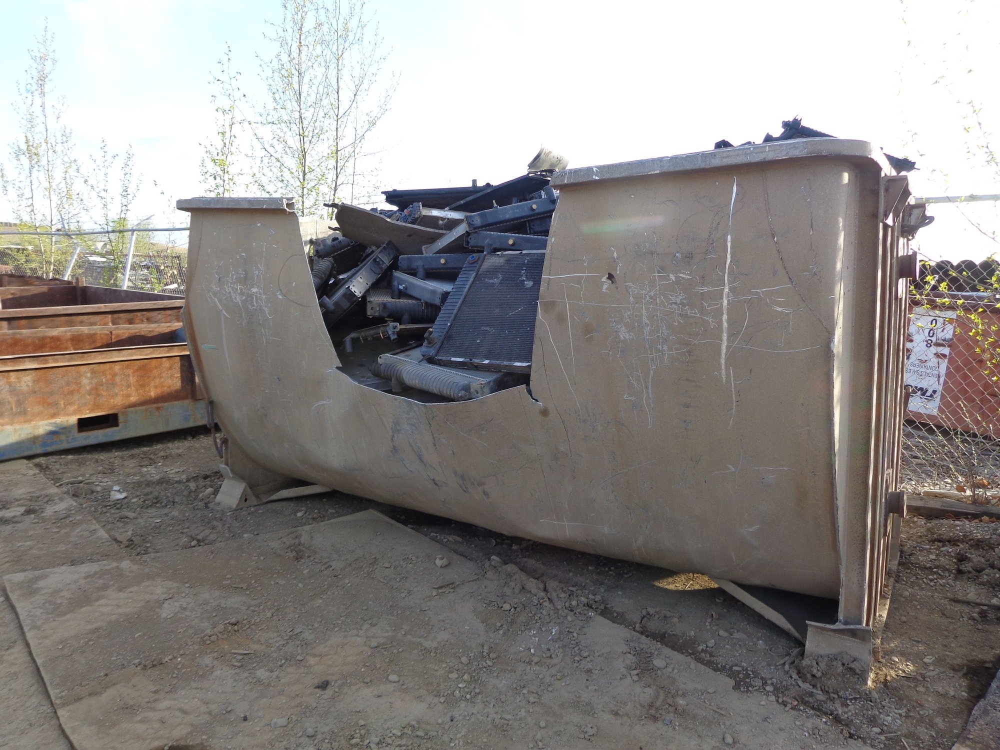

I see too many aluminum radiators go bad for various reasons but mainly cheap ones or by collision damage or by not using the correct coolant which would be like 1 in 20 that I can tell the core covered in massive coolant.....in that particular order -
One bin container completely full of bad aluminum radiators shown - which was empty 10 days ago -
For those who still run aluminum radiators in your old Ford Trucks that are trouble free - you all are definitely doing something right !!!
