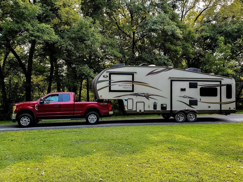

Can you transfer weight to front axle?
I have no experience with 5 th. Wheels. But have some knowledge about bumper tow. Yes I would say it is squatting too much. The trailer looks fairly level. If your 5th. Wheel has the adjustment to move forward without causing any touch points I would look at trying that.
Your CAT reading shows that you only added 40 lbs to the front axle with your trailer attached. There is a formula that I don’t remember off the top of my head that tells you how much should be applied to your front axle related to your load, 40 lbs is not enough.
On my current setup with a bumper pull when loaded and 1200 lbs bars adjusted properly my front end lowers 1 and a 1/4 inches.
Air bags are always nice with an onboard compressor. But your trailer is level. You need to transfer weight forward in my opinion. If your hitch does not slide forward you may consider a different hitch.

Went and got weighed and here are my numbers. Now this was after work so not completely camp ready, I did not have the kids, propane are about half full and no clothes in the camper but none of that should effect it too much.
You are good. Do nothing IMO. I have about the same setup as you except for the LB.

I had not thought of that but JDski has a good point. That pin needs to be just in front of the rear axle. Some hitches allow you to configure them with the pin a few inches back for clearance between truck and trailer. Get the pin further forward. If you need more space in there, longer pin boxes are available. And a longer pin box will transfer some weight to the trailer axles...but not too much.

My hitch is the b&w slider, its of course locked in the forward position when towing. It is set at the 1" in front of the rear axle. I can swap the arms around and move it to 3" in front of the rear axle but dont want to get so close to the cab on turns. So with it really only squatting 1 3/4" do I need bags? Have them ordered but not installed yet

Thanks everyone for the replies. First thing I discovered is my phone did something funky with that picture, if you measure the size of the rear wheel to the front theres a size difference, I dont know if it was the angle or my phone but after remeasuring the truck only squats 1 3/4" which I believe is acceptable. Im thinking Ill send these air bags back I ordered. All my other numbers seem fine?

I did tow at full weight last weekend in 20-30 mph winds and being my first time towing a 5th wheel it towed great. No bucking, smooth ride, no problems at all.
