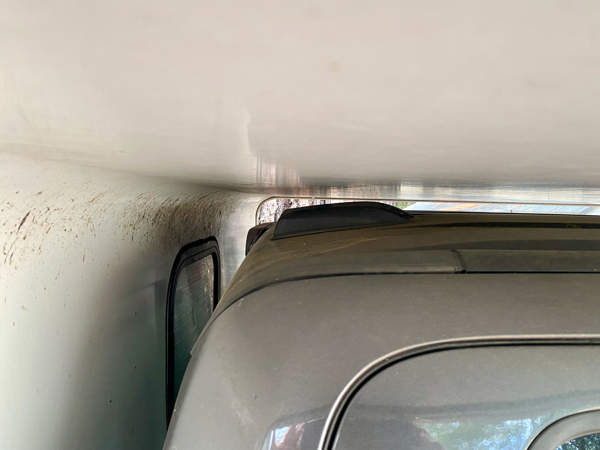

Since I was mentioned above, I should clear up the foam issue.
It was a long process of try/test/improve with the riser issue with a Ford F-series and a truck camper.
I think the foam base under the camper can work with a sheet of plywood on top. The downside is the glacial speed that the camper, over time, starts to rock and round off, side to side.
If you do a lot of off road travel, that downside picks up speed.
This happened to me, so I searched for a more stable platform for the lashup.
With a cedar bracket base (see another thread) under the camper and locked into the bed, I get no rocking, even over time, fore to aft nor side to side.
The distance between the highest place on the cab and the lowest part of the camper overhang is 1 inch. The camper and cab roof have never kissed. Nothing moves: side to side or fore to aft.
There is a wide variation in vertical offset between makes of truck campers. Each needs a slight exchange of numbers.
