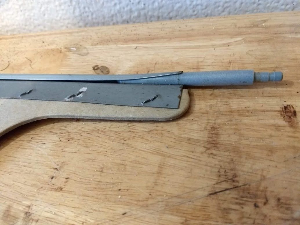

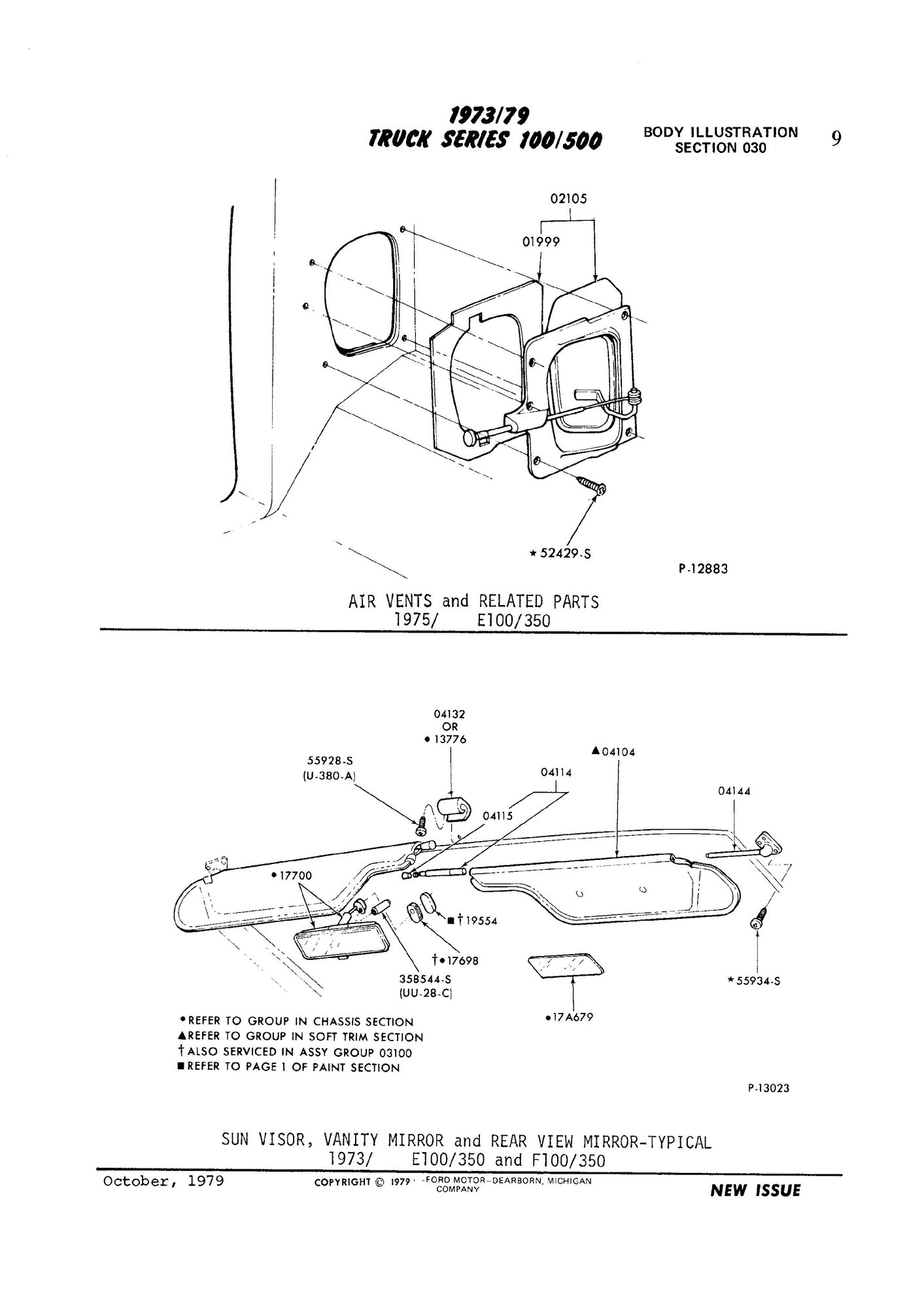

Here is great thread that shows you what is going on inside the visor. https://www.ford-trucks.com/forums/1...ors-ideas.html
You need to get the broken piece of the plastic rod out. Maybe get a hole drilled in the middle (of the end of broken piece) and then get a long (3") thin screw to take hold and pull it out. Replace with a piece of metal rod/smooth round barstock painted black and new rubber tips.
