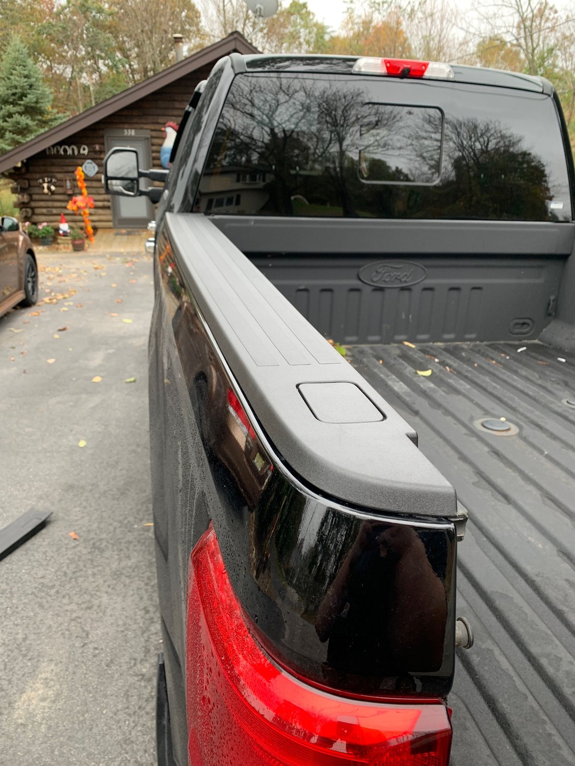

Is there anyway to get scratches out ....

No there isn't. May as well just get over it as there will be more to come if you use the bed.

That's what they're there for, to take the scratches rather than scratching the paint up. If it bothers you, hit it with a plastic cleaner so they're not as visible.

Depending on how deep they are, you could sand them out a bit to blend them into the surrounding area. They did their job by taken the scratch and not the paint.

I read your question and won't tell you how to think, my guess is your grown. I bet there is a way, maybe plastic welding with a same colored rod and if your real good you can put in texture. I can't solder or weld on the flat. I like a black permanent marker, sometimes jabbing to give texture making the injury dead black again. I think you could put black caulking into the injury carefully taped on both sides like a master remodeler caulking a shower unit, tool it with a wet finger take off the tape and tool it once more to lay down the edges, then maybe pebble grain it with a small artist brush. I would think it could be done
Other posters have a point thou. I like Mequires Ultimate vinyl or plastic protectant. It's more of a gel and that stuff I used on my prior trucks (mines new don't need yet), it soaks right in and leaves that shine on. It worked great on my step bumper plastic, mirror plastic, etc.........

I found a way
Heat gun for bigger scratches and for smaller scratches just rub with a tennis ball , also works on interior plastic

Fuzz on the ball acts as an abrasive w/o scratching, maybe creates some friction to soften too, never tried it.

Especially heat gun set at 1/4 of it s heat and keep it moving they disappear .... I use it as a work truck but I am careful sine I work out of a vehicle with a msrp of 87,000 dollars they are sending vehicles out before the plastic is even cured,,,,

dont use those cleaners they do more harm than good
Tennis ball or heat gun looks like brand new even know its only two months old
