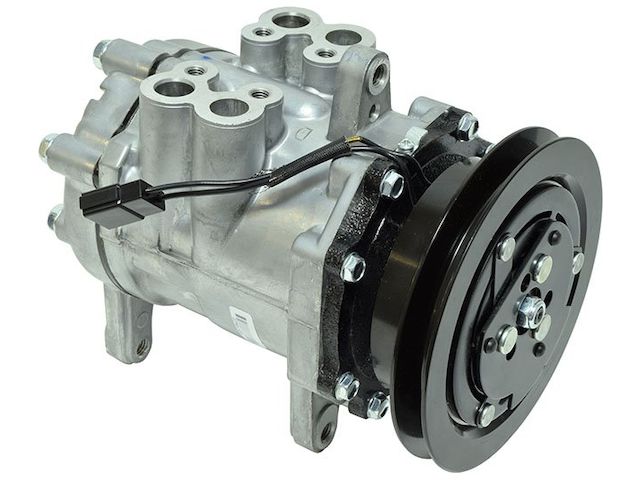

I keep seeing two types of FS6 compressor. One type with the mounting ears and one type with the 4 mounting feet. Which one is yours?
Here's what I am calling the "ear" type. Looks sort of like the Sanden.
Here's what I am calling the 4 mounting feet type.

In regards to your pictures, my FS-6 has the four feet and the one ear up top (with V-belt clutch). If I were to use the Lincoln bracket, I'd have to incorporate the idler pulley as well. From what I gather thus far, I will need a 2 sheave crank pulley and a three sheave water pump pulley. I know that the alternator, water pump and crank pulley's should line up just fine. My concern is once I convert the belt drive over to the 70/71 parts and am able to get my FS-6 compressor bolted up - will the pulley on the compressor (and also the added power steering pump) line up with the remaining pulley on the water pump. I don't expect anyone to know the answer to that for sure but maybe someone has done this before.
