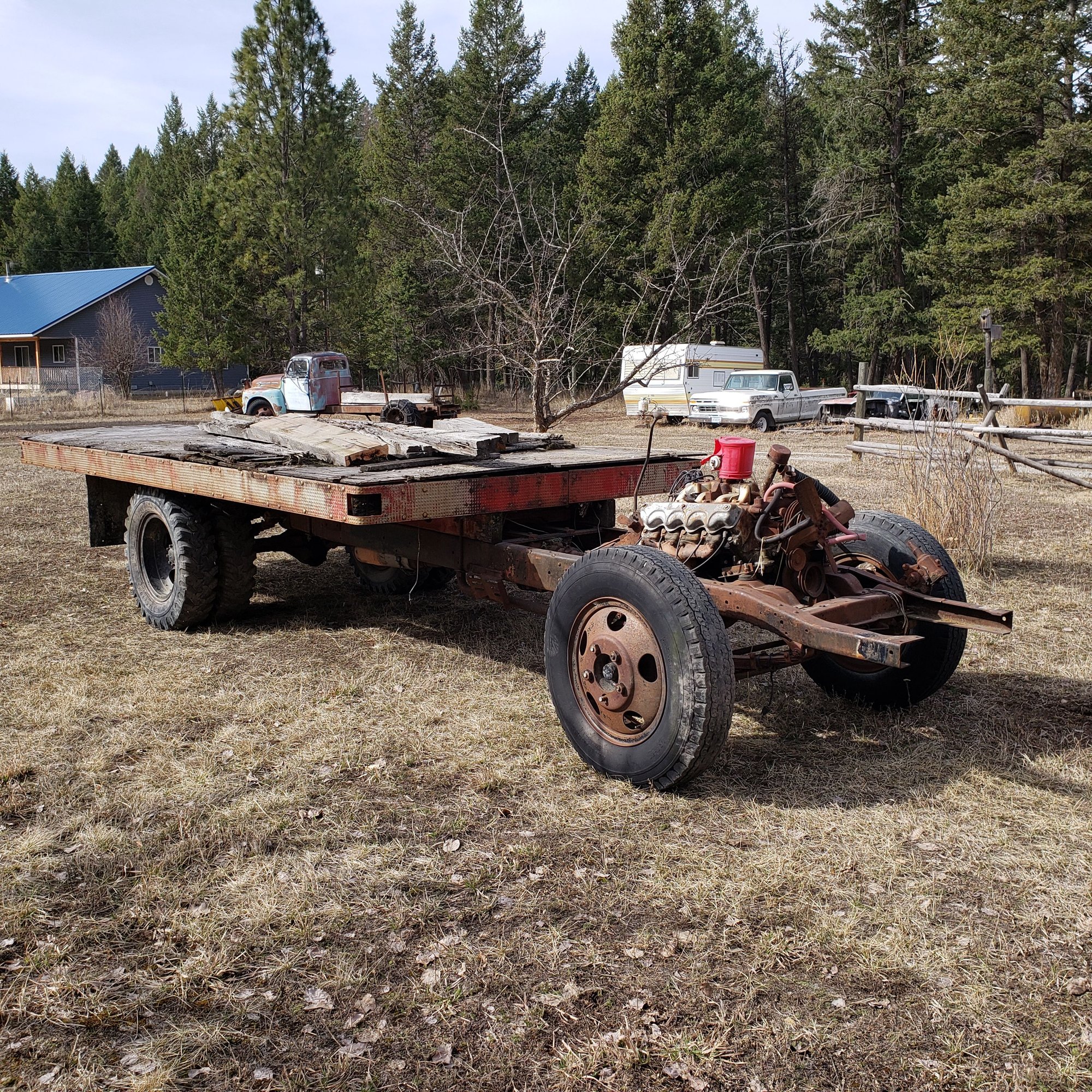

Also, I just dragged home a COE chassis/bed that turns out to be a '48. Couldn't find a frame stamping, but the trans bell housing is stamped *88RT33839*
An older friend gave it to me because I had once admired the Brownie behind the gearbox and he's getting rid of projects. He has installed a Chrysler 301 V8 with adapter plates to the ford 4 spd.
It has 3 split ring wheels of various heritage and 3 RH5's. Single spd differential.
I've never had a COE before so it's giving me something to investigate. Any input is greatly appreciated.
Not much to look at...

Update: 1948 appears to be correct
COE it is NOT
Measurements as I unwind things reveals a standard 158" wb standard truck F6 chassis.
It looks like someone found some COE parts and started a farm conversion. I have the steering gearbox from a COE and a lot of cobbled together attempts to make it all work.
They bolted on a 15'6" flatbed that would be more at home on my 176" wb 52 F6.
Good news: 3 good wheels, 3 widow-makers so from my other trucks I can come up with a full set of good wheels
Also, the double wall frame is in excellent condition so it will become the foundation of my 48 F6 rebuild.
Brownie overdrive unit is a bonus.
Oddity: It has a single speed rear end under it like an F5 which doesn't match the double wall frame?
