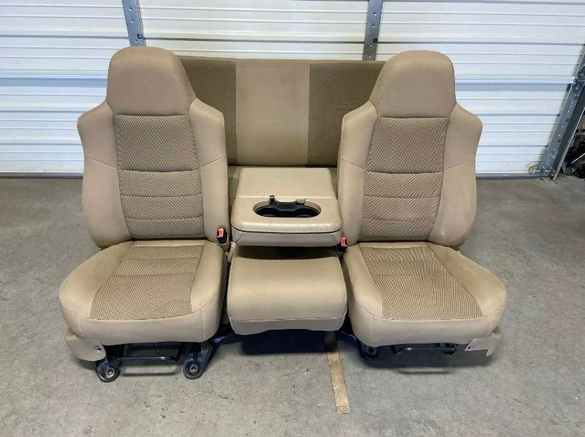

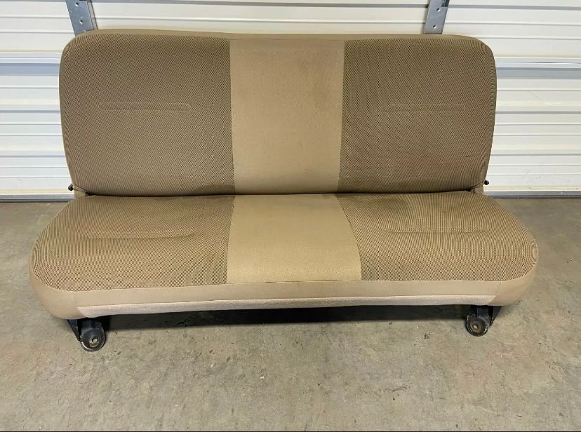

I have a 1997 F-350 XL Crew Cab. The truck has bench seats front and back. Would I be able to fit 1999-2010 super duty seats?

Modification is required to the seat ataching brackets for them to fit, but will fit inside the cab.

They’ll fit. May have to cut the brackets and weld them or get creative. But there should be a few threads on it if I remember correctly.

From what I have read, rear seats should bolt-in. Fronts will need a little modification to the mounts.

Wanna sell that rear bench?
