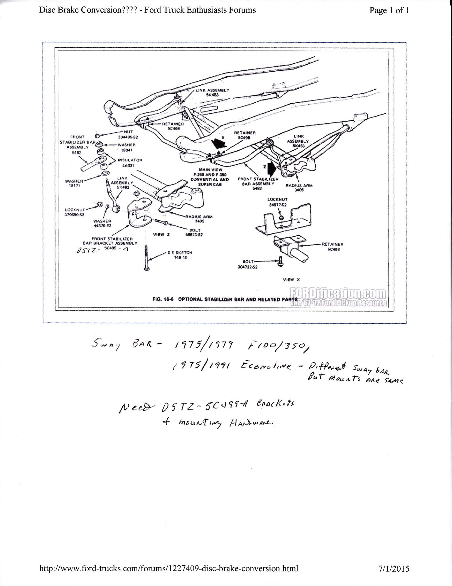

I have a similar set up. Click on the link below

All that stuff should bolt in as long as you use the transmission on the M. There are some slight differences that may require some modifications. The first is the spring towers if you look at the 78 you will see an indentation on the corner where the PS sector bolts to the frame. Your 66 probably doesn't have that. If not take a torch and a BFH and make one. If not he PS sector may hit the spring tower before it comes tight against the frame. Use the 78 radius arms with 66 bushings. Reason being those arms will accept an anti sway bar. If you are a lucky boy the 78 has one, if not you may be able to get the parts from a scrap yard if you want to have one. There are a bunch of parts to swap most are obvious but if you are going to use the 78 booster you will have to do some modifications to the pedal support to use the 78 pedal. What you are taking on is a BIG job, worth it but it's going to take a lot of time and effort. You also need to make the center cross member removable. Don't know about the radiator, it probably won't fit.

My parts truck unfortunately does not have a sway bar or power brakes. Thanks for the heads up about the ps, have not heard that. Just looking at it, i think the radiator will fit. I have already drilled the rivets in the transmission crossmember. I have did these kind of projects in the past. Several engine swaps, transmission swaps, put a 455 olds in a 73 chevy pickup. Swapped front steering & brakes from a 71 gmc into my 64 chevy pickup. I am getting too old to be real interested in doing this, but i am going to have all of the parts on hand. I plan on doing this in stages. Figure i will start with engine/trans, then go to brakes, then power steering. Learned from the past if you get too much scattered out at once its hard to get it back together. With a full time job, house 3 acre yard, wife and keeping a rig on the road for my 19 year old son plus taking care of elderly parents/inlaws, my 64 chevy and a little deer hunting, time is a premium around here.
