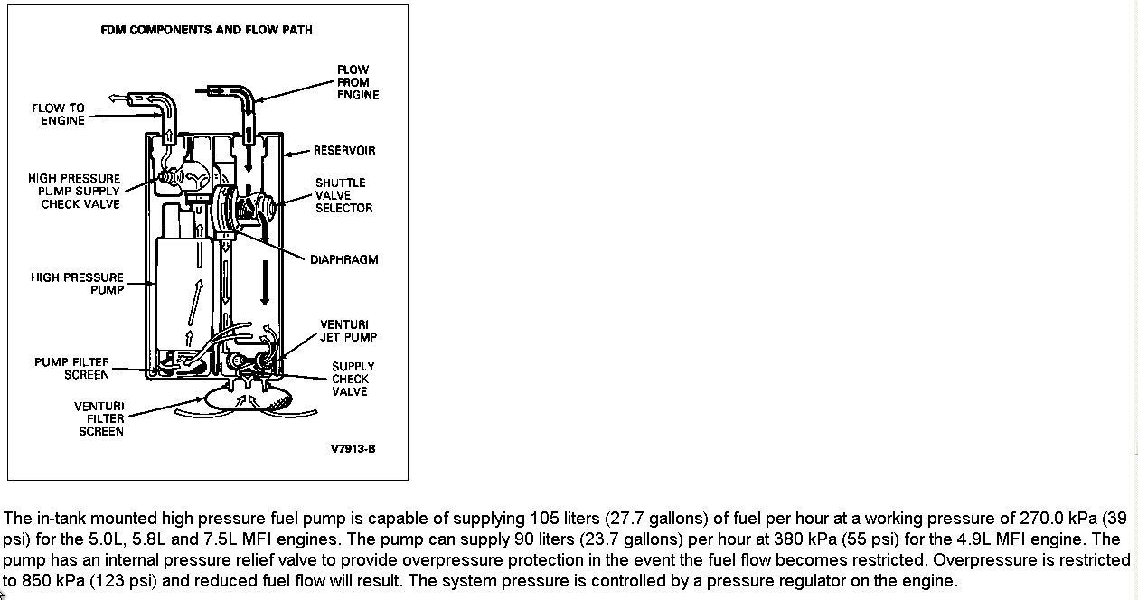

V8 engines running ~39 PSI the factory pumps are rated at 105 L/hr.
Before going any further with parts rent or buy a fuel pressure tester. That will tell you if you have fuel starvation. Tape the gauge to the windshield then drive down the street and punch the throttle a few times.Fuel pressure should rise under load/low vacuum conditions. It should never fall below the pressure recorded at idle with the vacuum hose attached to the fuel pressure regulator, ~ 29-32 PSI reported by most users.Full throttle/low vacuum the pressure should rise to ~39-42 PSI range.

Your stock fuel pump is rated at 125 L/hr.
Attachment 280162
