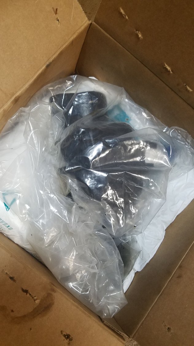

BlueTop steering gear delivered a few minutes ago by UPS. Very well packed with vacuum foam, robust box, tape and staples.

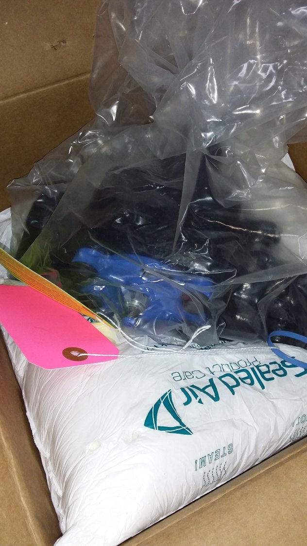

AutoZone POS edition steering gear out and boxed. BYE FELICIA!!!
