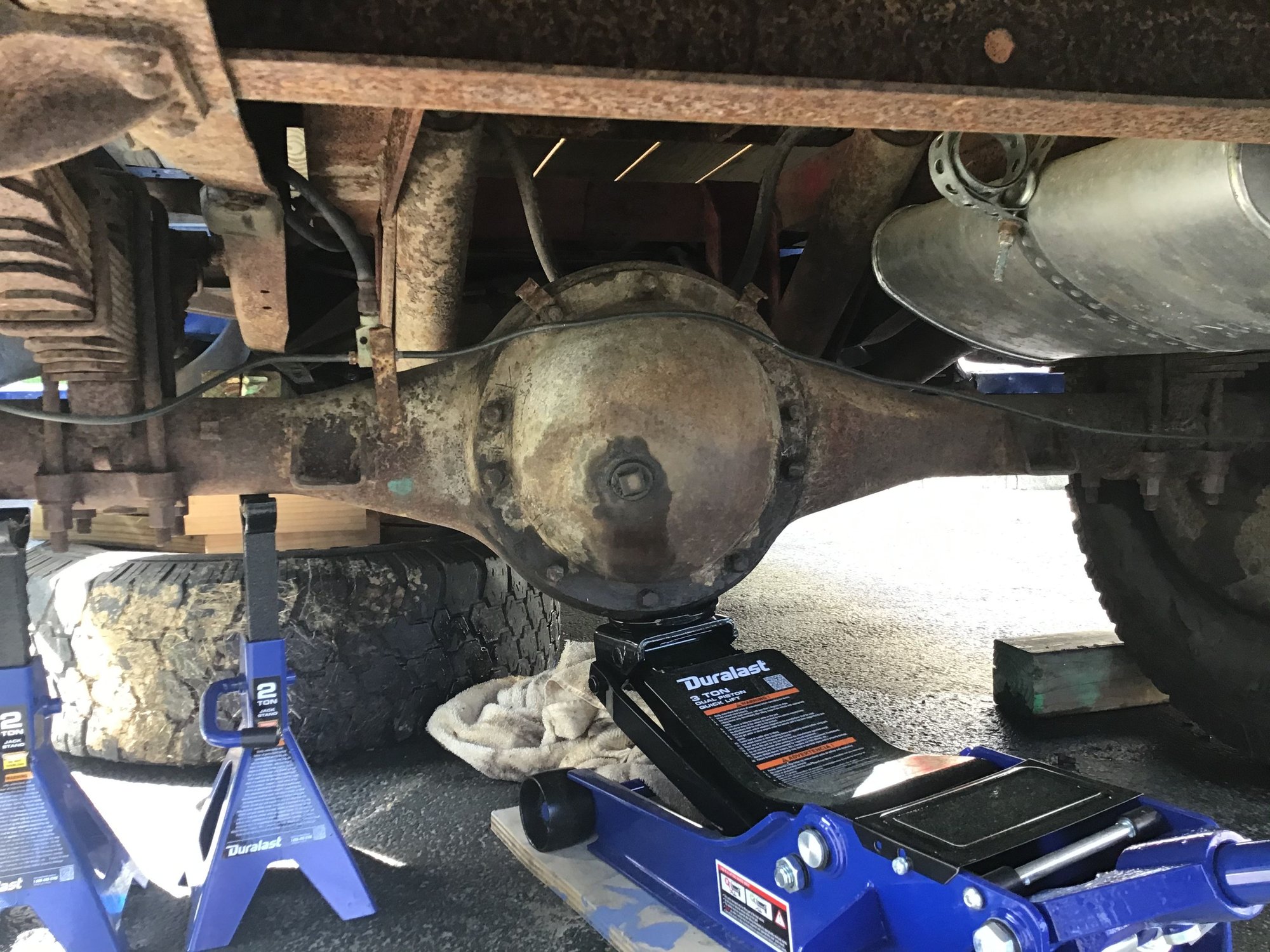

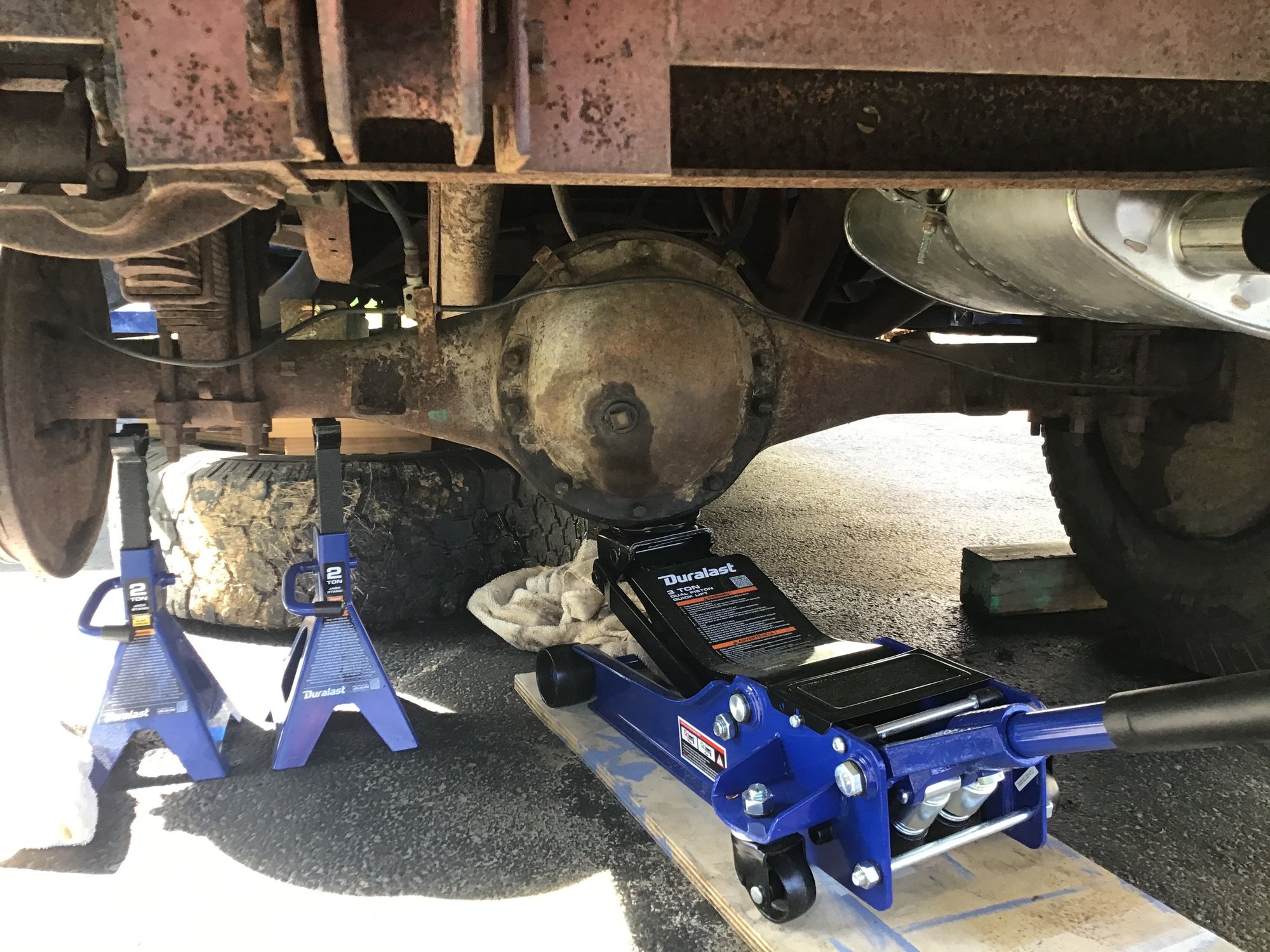

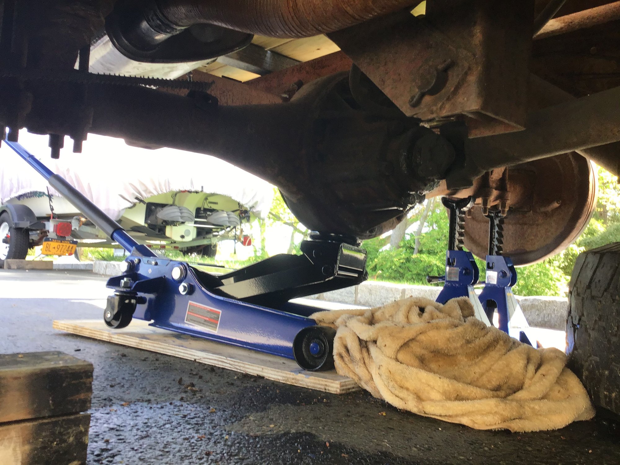

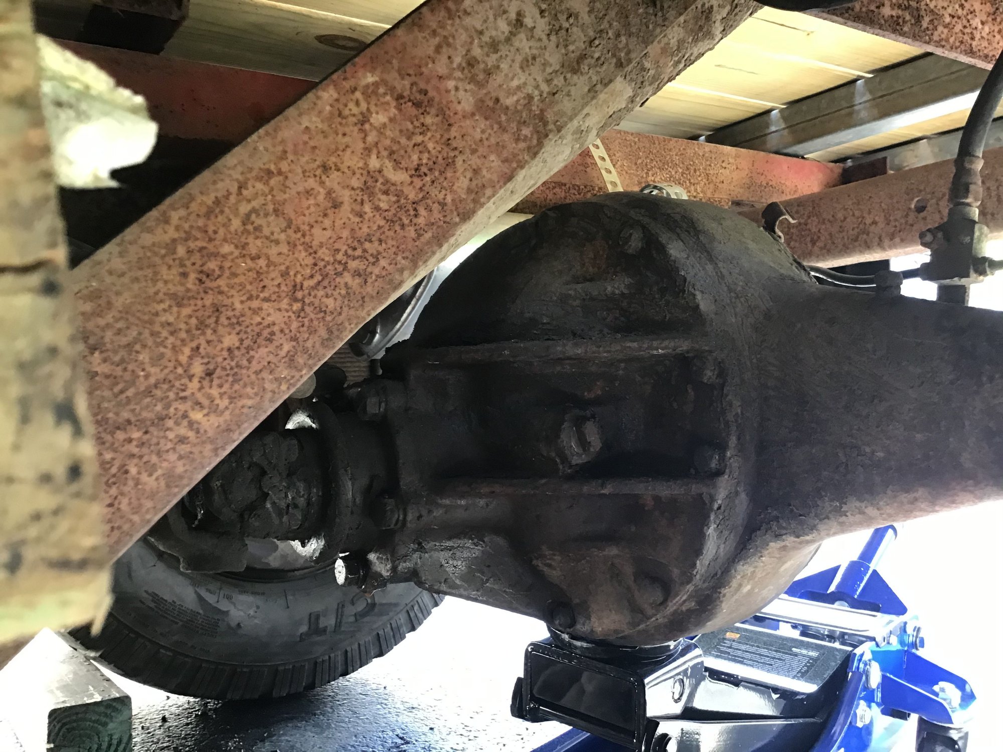

Is it normal to have two sets of spring perches?

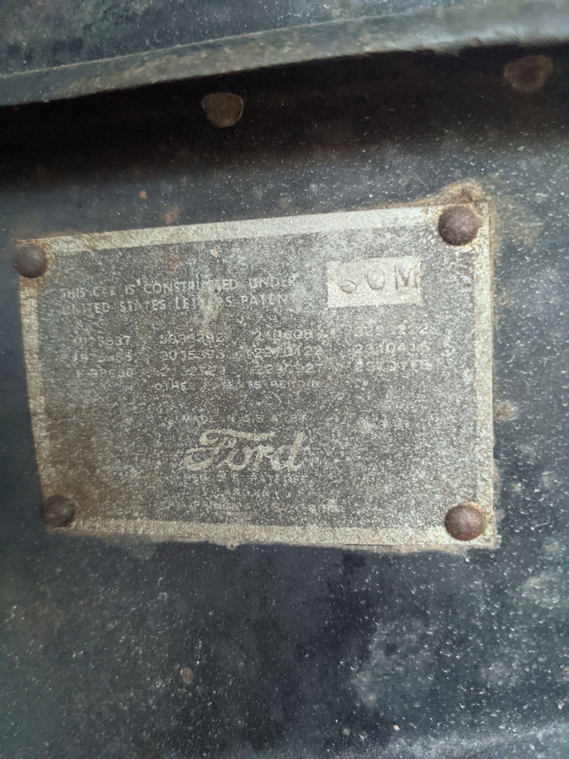

Very hard to make out the firewall tag

Something's definitely been altered on that rear axle and spring mounts. Front springs had either 8 or 9 leaves. You may be counting the caster shim as a leaf, can't tell for sure in that pic. The battery tray looks correct for a V8 truck. 6 cylinders had a mirror image tray on the other side of the engine compartment.
I have never seen a patent plate, the firewall tag, like that without the serial number stamped on it. The letters SOM would refer to the assembly plant, Somerville, Mass. It would still be interesting to see the production code stamping on the firewall. Keep looking for the frame stamp, too.

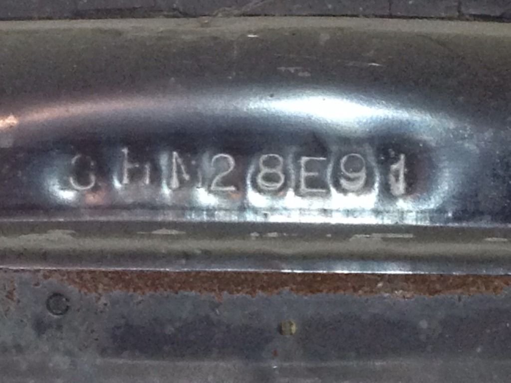

Here’s one of mine on a ‘51. Sometimes they are stamped more lightly and you have to scrub. Stu

It's not the serial number, it's the production code that's stamped into the firewall. Different plants stamped the trucks in different ways. Typically it's found either above or below the cowl seam across the firewall. A few plants stamped the number near the wire bundle hole.
