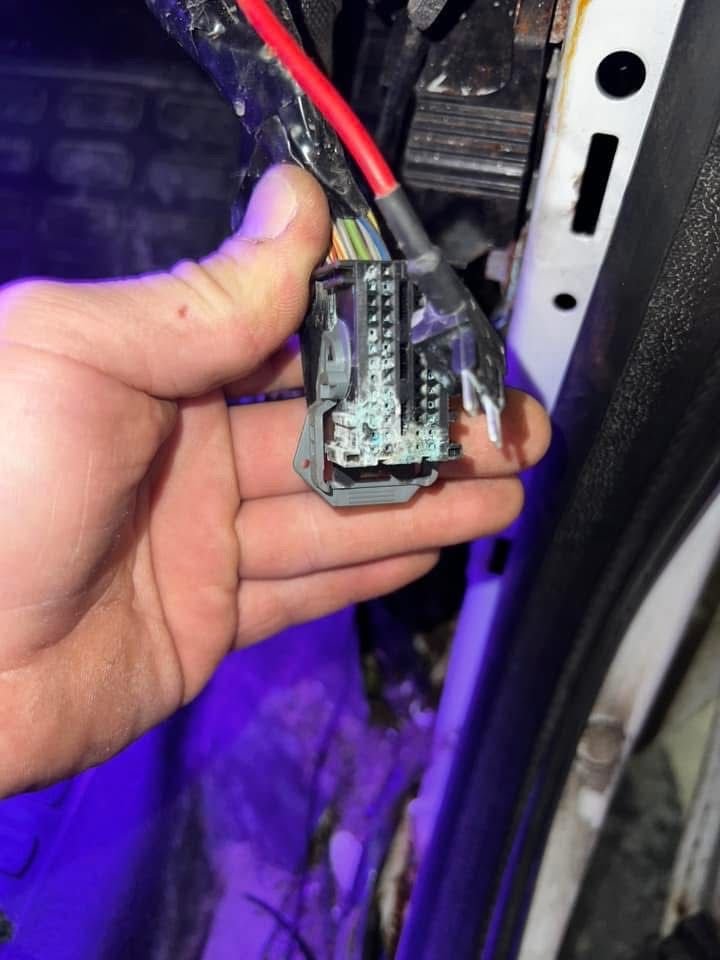

Update I found a broken cluster of wires in rear doorjam. Replaced with new harnessand rear door works. ALL DOOR LOCKS still do not unlock when I p[ress unlock. When I press Lock, ALL THE DOORS UNLOCK only if one lock is manually unlocked. Yes I said that correctly. The LOCK button unlocks all doors (IF I manually unlock one door by hand, otherwise no doors unlock with the lock button (They attempt and have signal)
Using a keyfob the doors unlock and lock. Same with code on the door.
Tested Unlock Wires and switch with multimeter. Got .4 Volts to the unlock switch. Lights are illuminated bright on the door lock switches. No Idea what is going on here.

Check all the plugs on the BCM for signs of water leaking onto it, common problem on these trucks.
