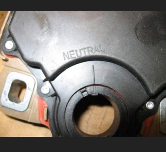

Old May 31, 2021 | 01:03 PM
Jim94F150's Avatar
Jim94F150
Joined: Dec 2009
Posts: 72
I put in a new MLPS and glad I did. Shifting is normal now, better than ever.
However, truck will not start! I can start it at the relay but don't see 12 volts on fuse 21 with the key in start position. Swapping the old ignition switch back in does not help. I see 12V coming into the switch on B4.
Could this be a bad ground somewhere?
Old May 31, 2021 | 02:53 PM
rla2005's Avatar
rla2005
Posts: 20,786
Likes: 1,751
From: Kentucky
Adjust the new MLPS.
Old Jun 1, 2021 | 01:58 PM
Jim94F150's Avatar
Jim94F150
Joined: Dec 2009
Posts: 72
The only adjustment I see is to loosen the two mounting screws and rotate the switch slightly. How does help for my no start problem?
Thanks
Old Jun 1, 2021 | 02:44 PM
rla2005's Avatar
rla2005
Posts: 20,786
Likes: 1,751
From: Kentucky
The start signal from the ignition switch goes through the MLPS before it gets to the starter relay.
Old Jun 1, 2021 | 02:55 PM
Jim94F150's Avatar
Jim94F150
Joined: Dec 2009
Posts: 72
When I bought the switch at O'Reilly's there were two the chose from. An 8 pin and an 11 pin. I picked the 11 pin as it looked identical to the original. Is it possible I installed the wrong one?
Old Jun 1, 2021 | 04:45 PM
tjc transport's Avatar
tjc transport
i ain't rite
Joined: Mar 2005
Posts: 65,515
Likes: 5,567
you can not just slap the switch on and expect it to work. you have to adjust it.
Old Jun 1, 2021 | 07:01 PM
  #28
Jim94F150's Avatar
Jim94F150
Joined: Dec 2009
Posts: 72
So, loosen the mounting screws, rotate the switch, and re-tighten? Repeat until it works?
Old Jun 1, 2021 | 08:28 PM
  #29
Mark Kovalsky's Avatar
Mark Kovalsky
Frmr Ford Trans Engr
Joined: Aug 1999
Posts: 24,725
Likes: 2,652
From: SE Florida
In the center of the sensor is a ring that rotates with the shaft. It has a mark on it. When the trans is in neutral align this mark with the mark on the shell of the sensor. Then it's aligned properly.
