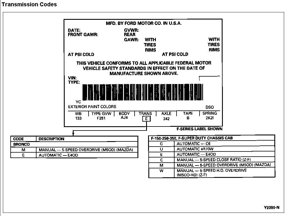

If it's an automatic, it has the E4OD. If it's a manual, it either has the Mazda-5 or the ZF-5.

Most likely your truck has the E4OD as stated above, but there is a slim chance it could have a C6. Check the Trans code on the sticker located on the driver side b-pillar.
Trans code G is a C6, E is an E4OD.

If the OP has a manual, it would be the ZF. The Mazda trans would not be behind a 460 in an F250.
