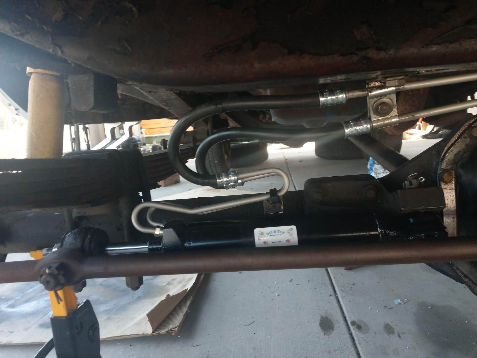

I just wanted to give a shout out to Blue Top Steering Gears out of North Dakota. Great customer service and top notch quality on their parts. They refunded me on my core deposits right away. Anyway, steering is done now but lots left to do on the truck. Cheers!

Looks like they supplied the correct hoses too! I bought hoses from a local parts store....never did fit correctly from pump to to control valve. Glad it worked out....bit pricey but all depends on what you want.
Glad you are happy with it. Blue Top and Red Head are probably the best on steering rebuilds for these old trucks.

Actually the hoses are RockAuto but with the usual amount of drama and wrong part selection. Mostly my bad but I got it right in the end.
